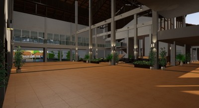

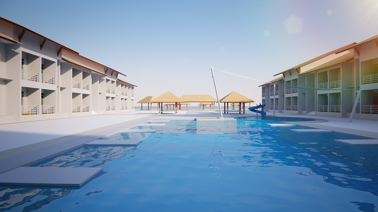

hi guys,
i have problem with light setting for interior resort lobby. this render took 30 minutes for hd 720p resolution (total frame 360). need some help with lighting setup & less render time.
thank you.
thank you.
Azmen S. O.
http://www.asbostudios.com

i see u have 2 problem here not really problem . 2 things i mean .
1 . lighting
2 - surfaces .
but nice render keep going .
if u need realistic render u dont care about render time .
by the way really nice realsitic details (Y) . good luck .
about lighting interior and exterior very easy . i put scn lighting setup in kray scn depo .
there u go :
http://www.kraytracing.com/joomla/forum ... pic#p19197
GLuck.

Re: resort lobby test render
you need to work very hard....can test lightwave3d scene or try this
http://www.kraytracing.com/joomla/forum ... =viewtopic

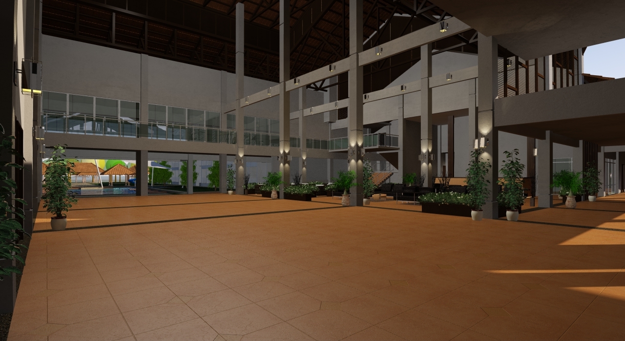

thanks and really appreciate for the scenes brothers. i've seen both scenes and u are using area lights. the one I did was lumi panel. what is the different between the two lights anyway?
anyway here is the update perspective. I used a lumi panels at the lobby area. need some comments.
thanks
thanks
Seems to me that the hallway like areas should be much brighter. Probably not bright enough with lumi polys. Also a space like this with such volume might have some overhead lights, high pendant lights etc. Not sure if this is artistic or fully designed from arch drawings...
It all seems a bit dark to me. But from first image to second, your making great progress!
azman_821009 the update it's > quality.
now you can work on surface.
floor need reflection + blurring
light power need + pover - so i think work in pwer 1.0 - test 1.5 or 2.0
active physical sky and playng with tonemap.
and read the tread as this:
thanks for the comments guys. this perspectives took almost 3 hours ++ for render time with resolution 3730x1754.
It's normal for render time for the resoultion? And how can I reduce the render time for animation?
Please just post this scene (no details, only walls) Will try set up light for you.
yes janusz u right
poste it man ^^
poste it man ^^

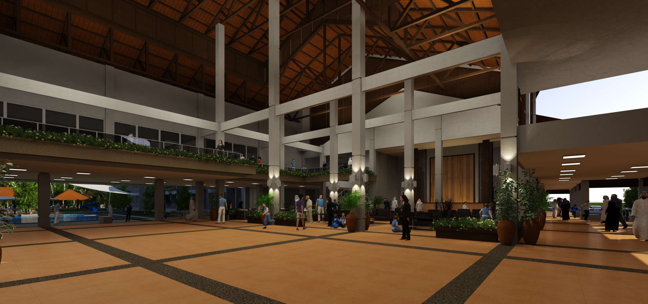

Now I know why you have "flat feeling light" because of Gi resolution. It was really too big for this scene (over 2 meters) Also very bad setup with GI.
Here my 5-8 minutes renders + QMC + fast AE. I used only Physky light.
thanks for the comments Janusz. usually for the exterior i used GI about 2-3 meters & for the interior is about 250-500cm
.. are u using just only Physky Light? no additional light? i'm still not familiar to play with tone map.
Azmen S. O.
This resolution (2-3 m) you use for bird eye renders because detail are far to waste time for good GI, but in this case 500-600 mm is ok.azman_821009 wrote:thanks for the comments Janusz. usually for the exterior i used GI about 2-3 meters & for the interior is about 250-500cm.. are u using just only Physky Light? no additional light? i'm still not familiar to play with tone map.
Use this tonemap:
