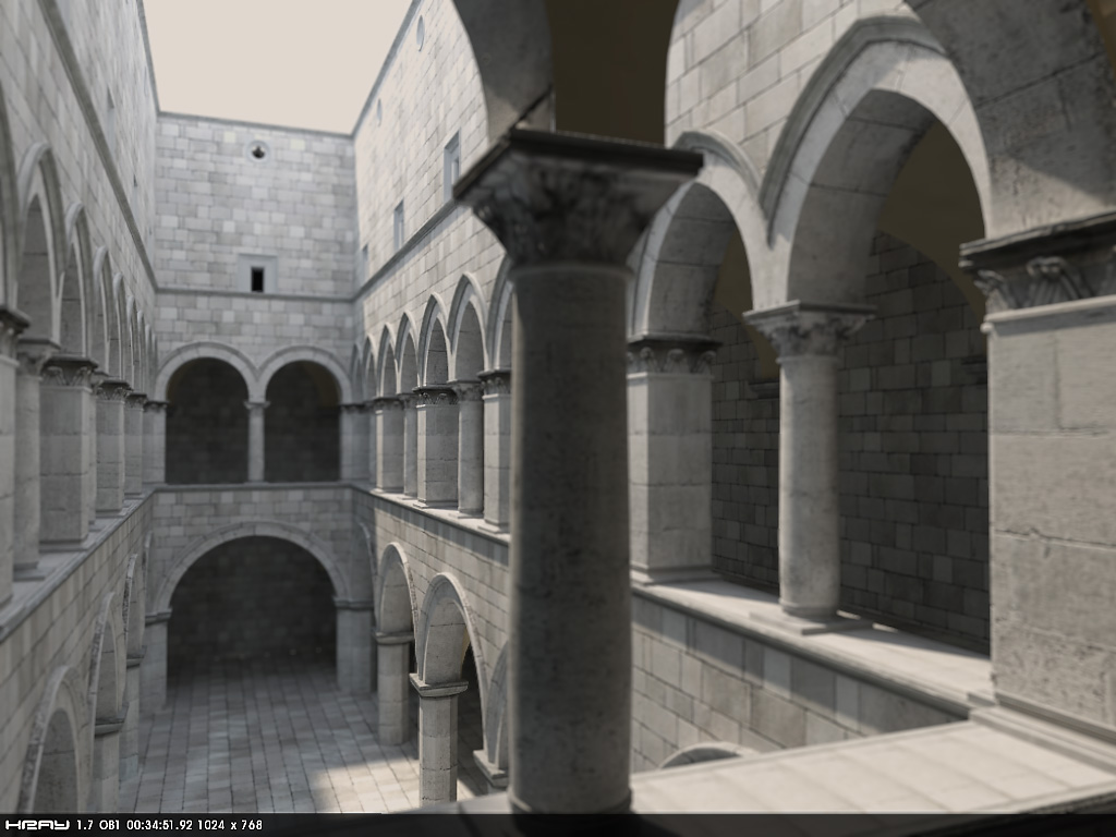

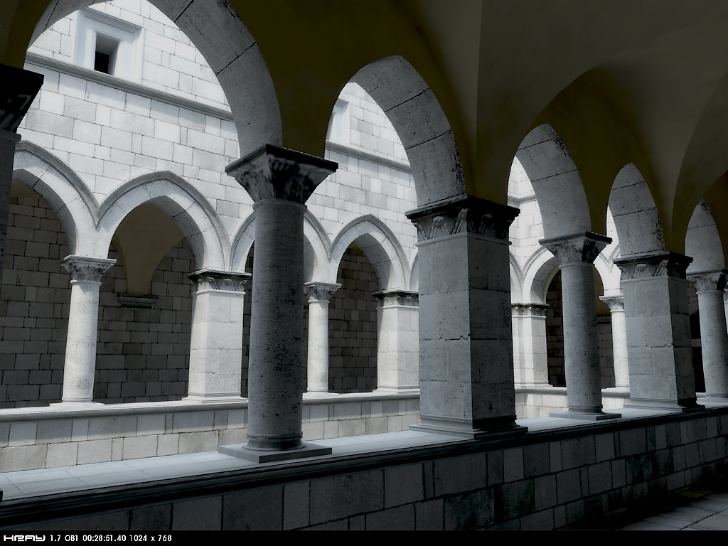

I use only Z-buffer (this is perfect!)
AA use in Kray:
Preset - MEDIUM.
Sharpnes and Dof add on Photoshop.
look:
