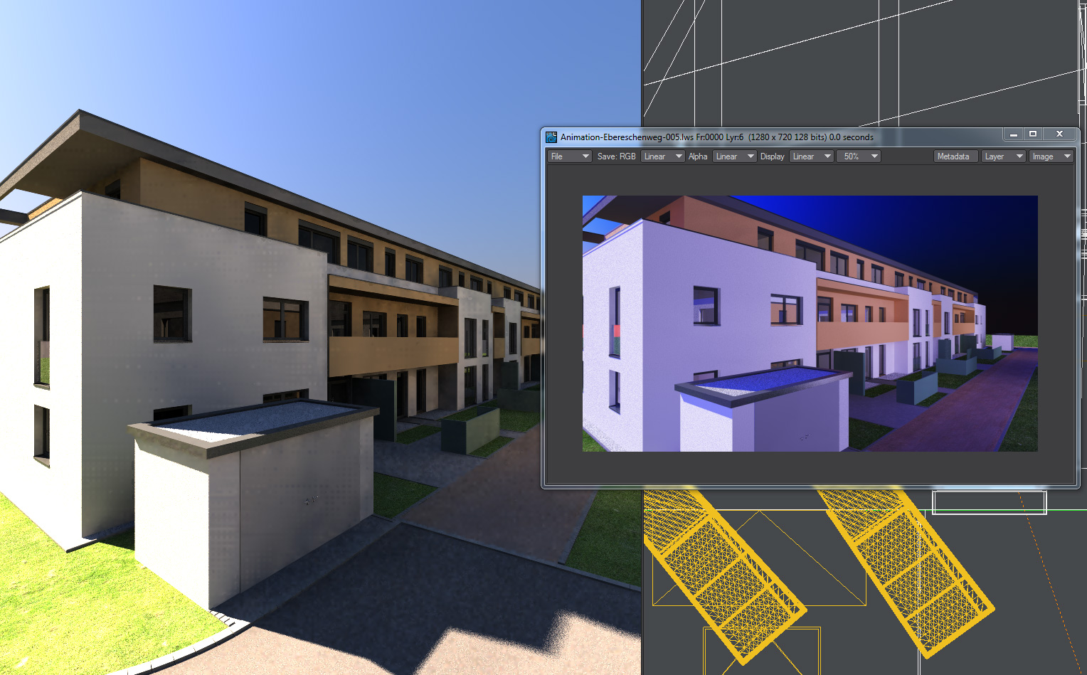

I have some problems to achieve natural results DP-Sunsky /DP-Sun Light with kray renderer in the latest builds of kray and LW.
With VPR it seems to work like it should do but the kray output is far aways from what i was supposed it should look like. Is kray still able to work with the DP Sunsky /Sunlight plugin in a right way?...or what might be else the reson for the strange output.
See attachment -> Right: Kray output Left:VPR Screenshot

I suspected bad tonemaping in your renders but I had to check (strong blue)
Just turn OFF Quick LWF. Do not use strong Exponential in tonemap blending - just more gamma then exponential. If you want exactly same render VPR/Kray , then turn all tonemaps systems in Kray (default Linear).
Re: Kray | LW 11.6 | DP Sunsky
Ups....i´ve found the problem. All the Kray scripts and Kray Plugin were integrated twice in the scenes masters. now it works like it should do.
Yes also this is bad, because setup is taken from top one....Steel wrote:Ups....i´ve found the problem. All the Kray scripts and Kray Plugin were integrated twice in the scenes masters. now it works like it should do.
