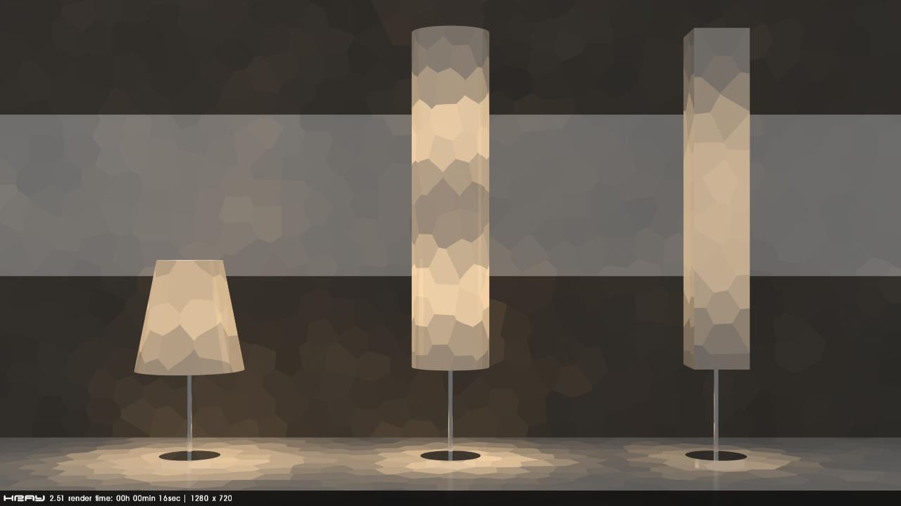

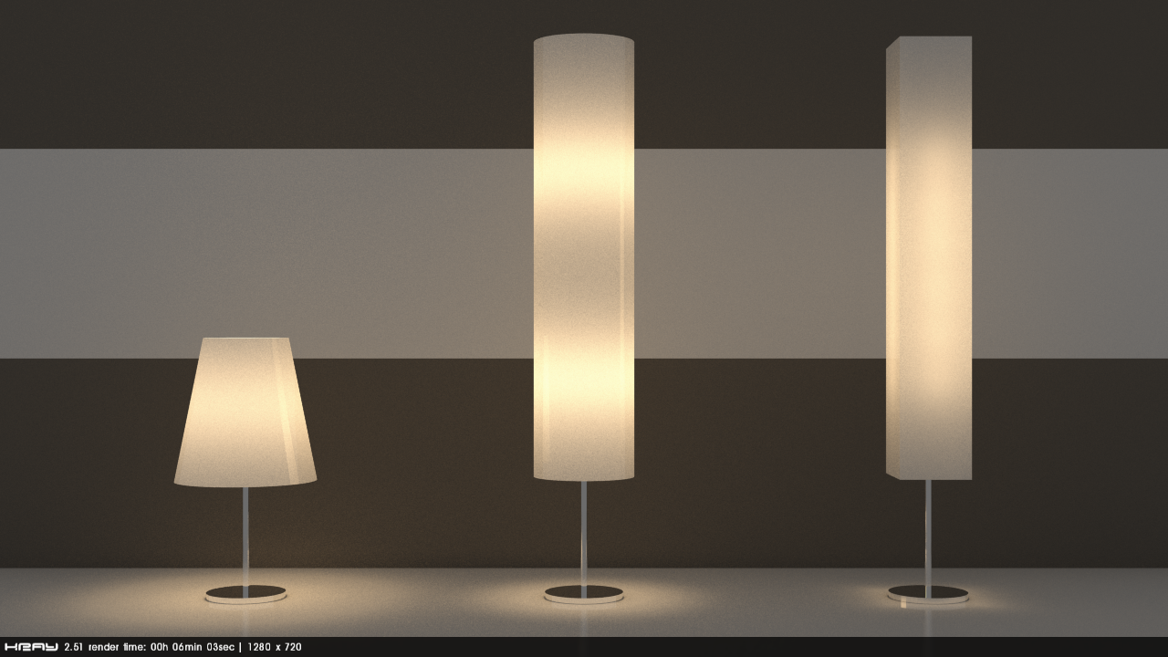

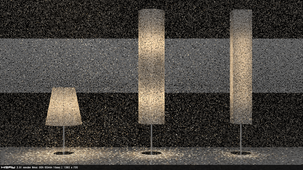

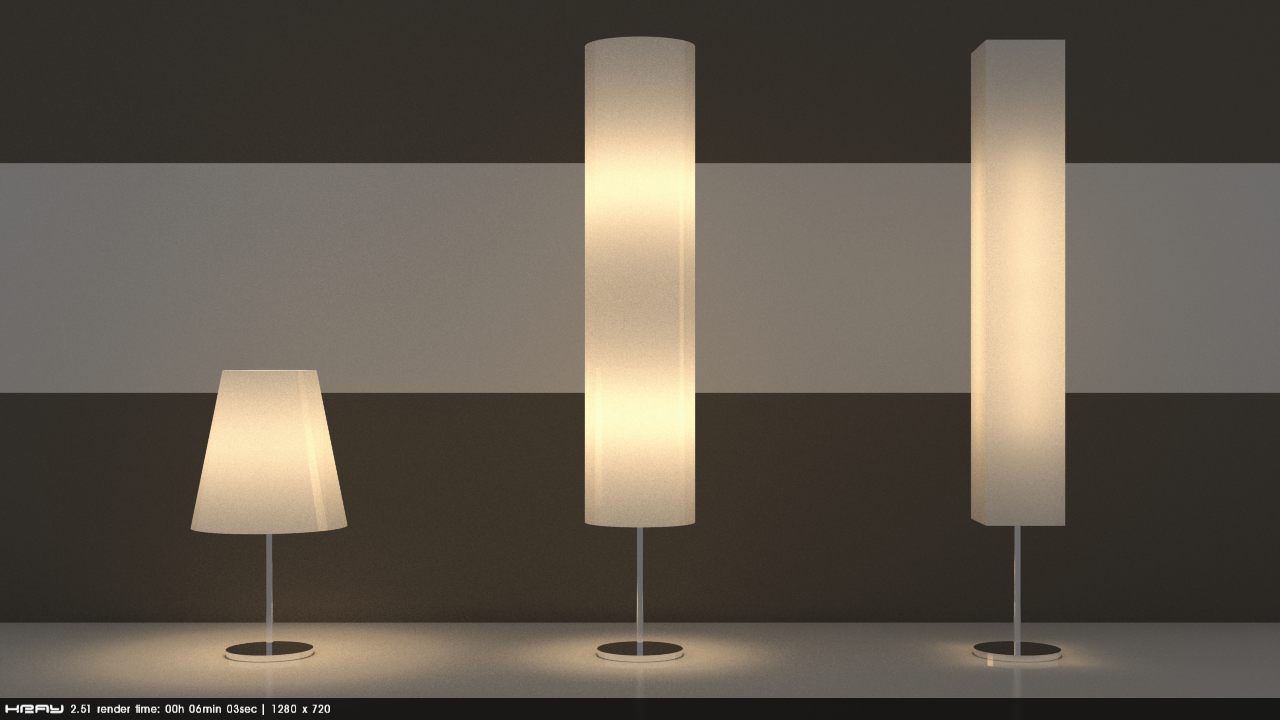

So here scene. The setup is easy: Physical Light inside and Double Translucency (can be also normal translucency but by Double system I reduced not necessary photons inside lamp shades - so they travel only from inside to outside). I think this is meaning in V-ray shader...we do it easy by powerful LW Nodes. I think V-ray shader reduce also time render and increase quality but I am not sure about this.
This can be used also for leaf surfacing but instead colour we attach two different textures. Actually this is the best solution for plants.
The meaning of this Node is exactly same as V-ray shader.
