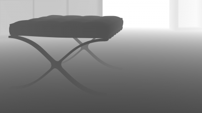

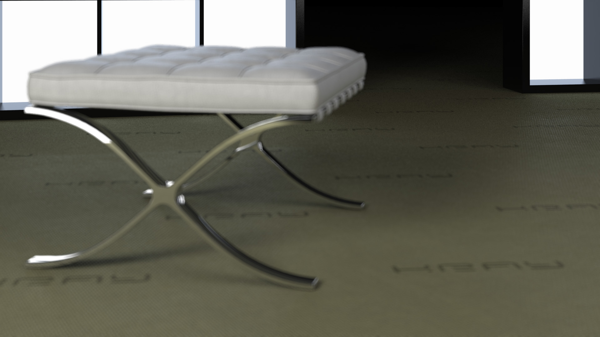

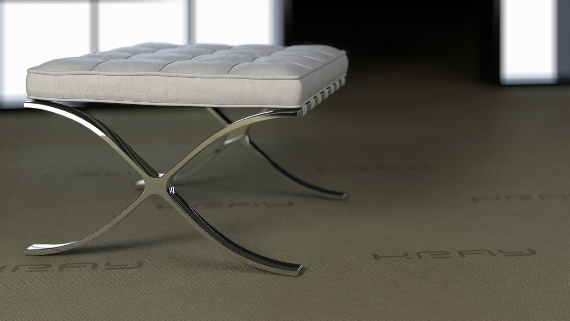

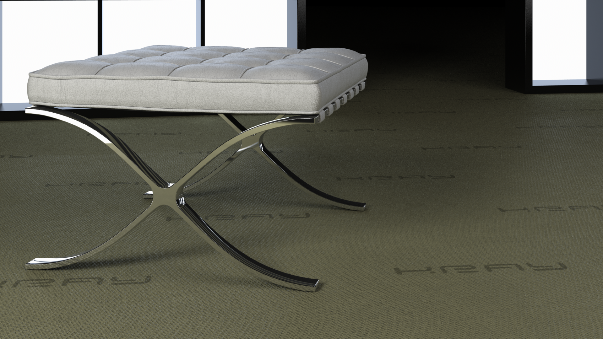

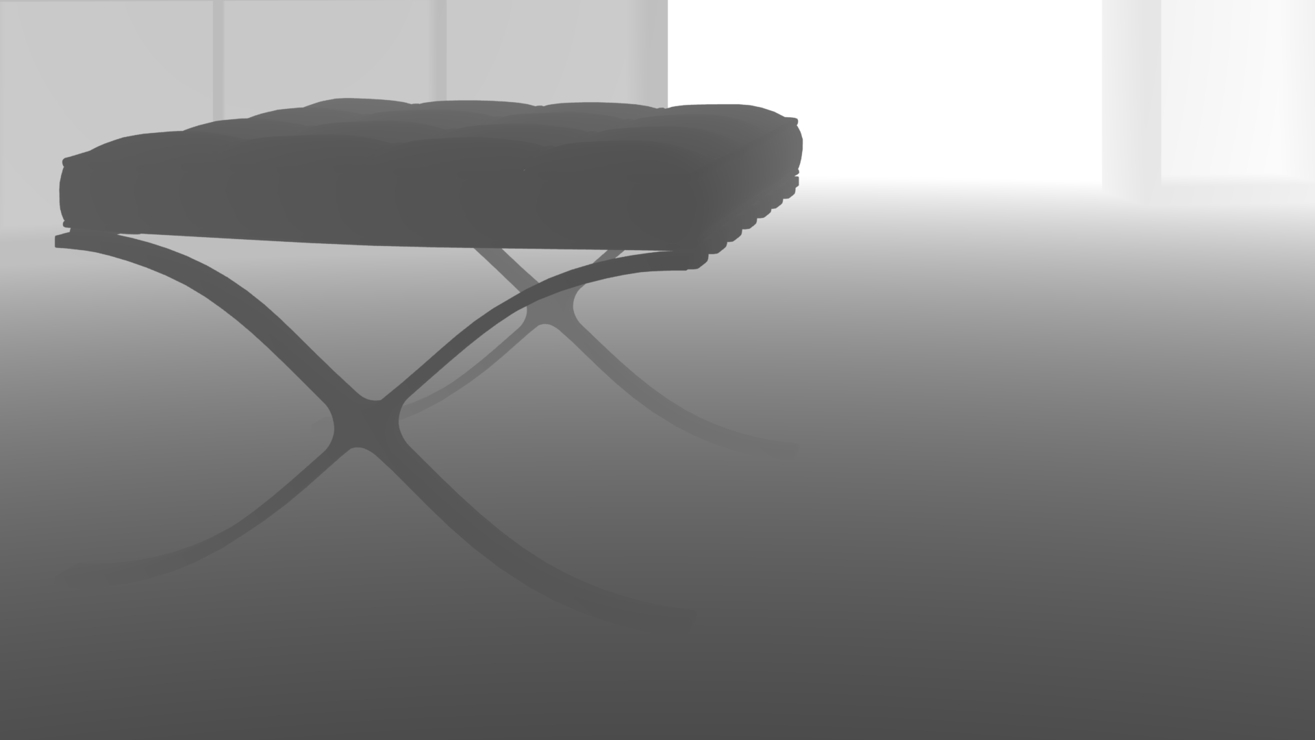

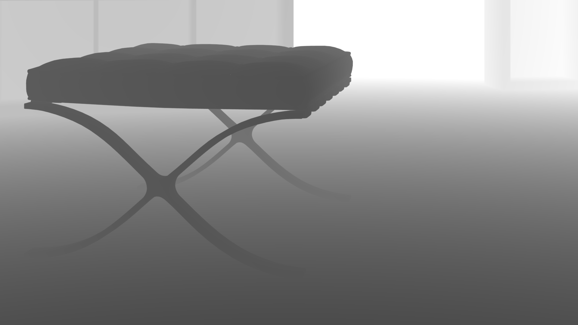

It is also some rules with you must know:
- never setup Z-buffer distance in static distance! Example:
if object which you want show in focus is 2 meters from camera - Z-buffer should be
0-3 m. The IMPORTANT think is to have the smallest acceptable RANGE in Z-buffer setup - it will make better effect without "ghost" problems on the edges.
- if object or group of objects or region is far from camera then Z-buffer must be setup with different range. For example distance to object is 8 meters - then Z-buffer
should be 5-15 meters.
- The distance Range setup need training and also thinking for future what we want show in animation (with still images is easier)
- The best software for DoF by Z-buffer is ONLY DoF Pro in Photoshop. Doesn`t exist better ! Has only one problem: animation system setup is bad. For still renders is perfect. I think only this software offer options which prevent "ghost" edge problems.
- The best software for animation in AE is FIRSCHLUFT plugin - but has one problem:
no Alias Depth Map which prevent "ghost" problems.
Generally: for still images DoF Pro, for animation FIRSCHLUFT plugin.
-now the worst think: Z-buffer need a lot training. Both software are very, very easy but to achieve good result...stunning results it need really good imagination and training (I thing generally DoF is the most difficult part in renders and is doesn't matter what DoF system we use)
- Never use .jpg system files in render with Z-buffer
In attachment RAW render directly from Kray for training and my examples (a bit exaggerated to show IRIS effect)

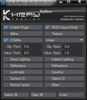

How do you get KR to save the ZBuffer? Please point me to what tab/command etc. I need to turn on.
Re: How do you use the DOF Target option
3dream wrote:How do you get KR to save the ZBuffer? Please point me to what tab/command etc. I need to turn on.
Answer is above your question...maybe you missed image from my post. In pre last tab menu in Kray (plugins) you have Add/Edit Buffers.

Post by 3dream »
Yes I did miss that. Perfect. Thanks. So I will go to plugins tab and enable the buffers export option! Thank you.
