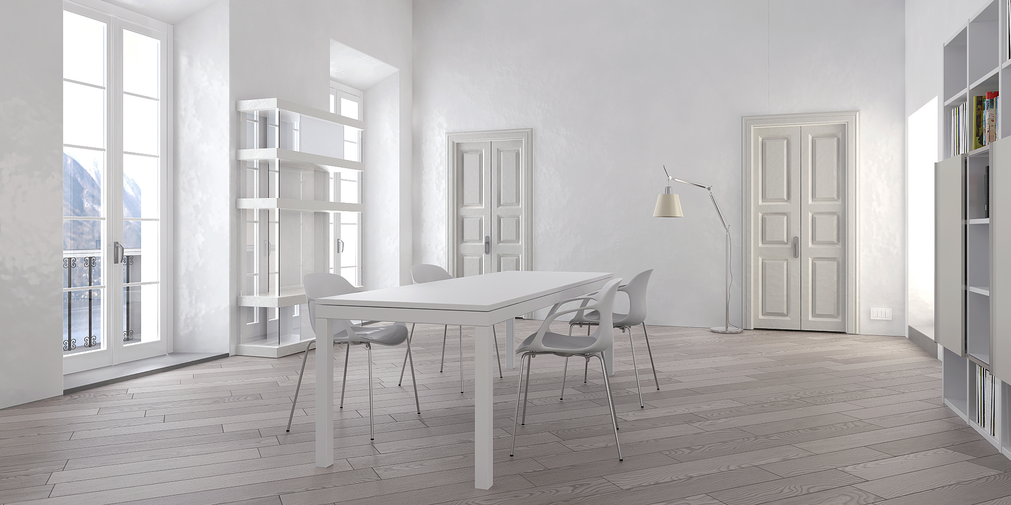

same here:
I think you waste time for Procedural Textures and Final gathering.
In first you should start mix real textures in LW system or better in Nodes.
In second just use QMC setup in Kray...Is the same time render with perfect GI...
One more think: more quality for modelling details (door, handles, sockets)
Rules number one : do not use basic stuff from LW CAD (it is only for speed modelling)
Reflection on wall need fresnel effect.
..but the light is good

tnx Janusz
your advices are very appreciated

real light there . nice keep going man
u c an delete lumi panel on ceiling u dont need them in this case i think .

in this render I used only phisical with lumi panel in windowslightwave3d wrote:real light there . nice keep going man

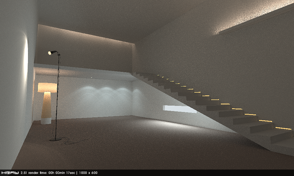

Hey Janusz!
Why IES lights do not produce soft shadows? Is it because of IES file or is it because photometric lights cannot produce soft shadows?

It should produce soft shadow but it depends from IES file (some produce sharp shadows because they have very small cone)medzo wrote:Hey Janusz!

yup, soft shadows are based on type of IES file... do you know how to recognize that type of IES? or just trial and error?

Sometimes IES file make error in render (broken IES or wrong file?) also those with small cone angle are more sharper. I think generally it must be very wide. This is only one source of light which make soft shadow after Area Light. Spot lights are not supported in Kray.
For fast preview you can switch folder view to "Large Icons" or "Extra Large Icons"
Quality control for IES Lights (noise control):
Kray Menu - Quality - Luminosity min/max
Average setup 30/100.
Also this setup control Spherical light quality shadow.
