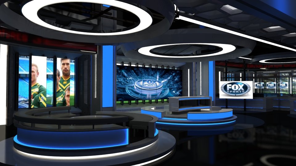

Hello. It seems Kray is best suited the scenes that have some component of external lighting. I was planning on using Kray to render scenes on TV and Film Sets that dont use exterior lighting. Is there a tutorial somewhere that describes the best way of setting up a scene using ONLY standard lights and NO daylight?
I have tried to get Kray to render an existing LW 10.1 scene that already has numerous lights but none render. Am I doing something totally newbie-ish?
Thanks. Phil
Thanks. Phil

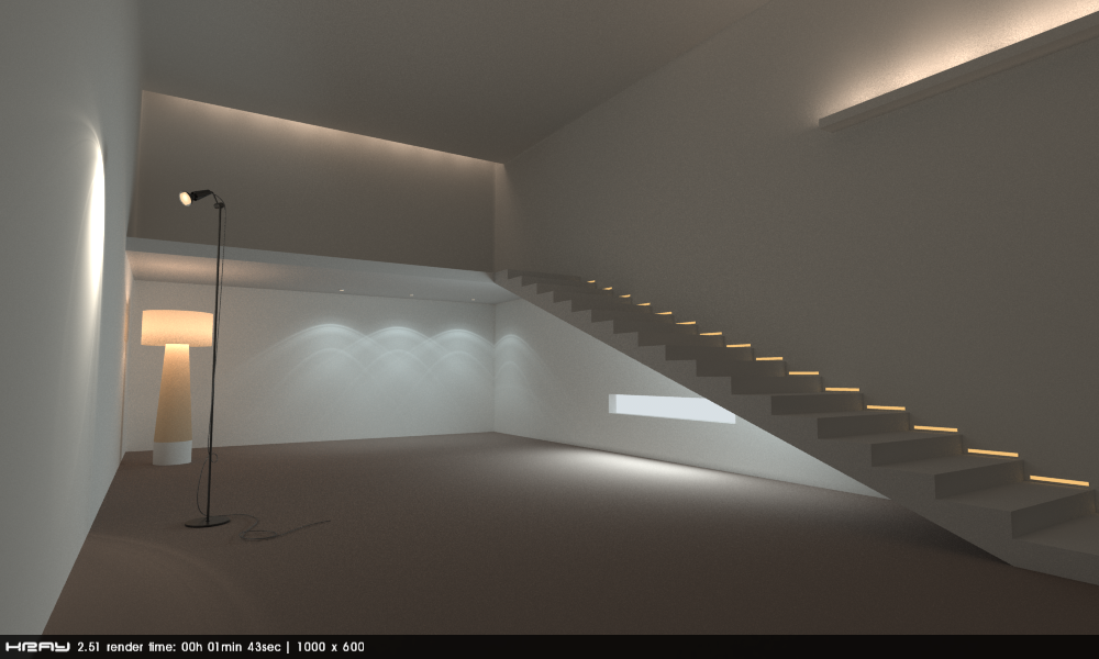

I suspect You need to render without Sun and Physky so night scenes or closed rooms.
Actually is the most easiest think in renders.
Why I say easiest? because for that I use only physical sources of light. It make very clean photon map and no big problems.
Possibilities of use lights in scene are huge so this is just small example.
Now rules:

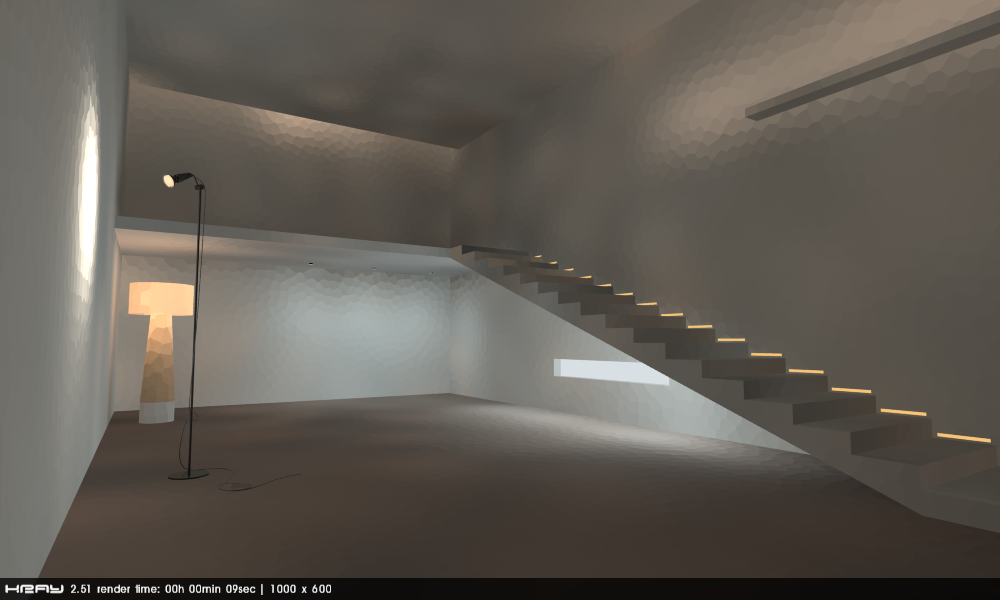

1. Do not stretch too much Area Light - it make "brake" of continuum (it is no bug , Physical lights are emulated in Kray and to clean this effect you need raise up min/max for Area Lights quality for example 2/4 or 3/4 - it will make longer time render so better is to put two shorter Area Lights instance of one.) Example on the right side of scene. Good example from ceiling lamps where I put two of them
2. Do not put Area Lights near objects (wall) it will make noise near lights (it is no bug). Problem comes from strong photons. Good idea is too move light a bit farther - example light on the right scene.
3. Do not use Spot Lights - better IES

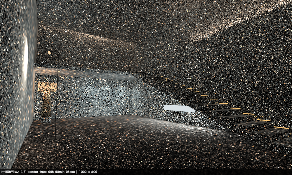

4. Do not use lumi lights with high luminescence! It affect strong "hot photons" (it is no bug) and this is normal. Render engine doesn`t know which light is Sun and which one is bulb. This is all the time problem in all kind of renders engines. Why I use Physical Lights. It is correction tool for this problem in Kray...but it works randomly and is difficult to use.
5. More light - more problems. Problem is smaller with Physical Lights (actually my record is 220 Physical Lights - Auditorium scene http://www.kraytracing.com/joomla/phpbb ... &mode=view ...so is not that bad). More Physical Lights - longer time render because grows amount of raytracing calculations.
6. If you MUST use lumi lights (small lamps over stair steps) then make maximum 100-200% luminescence level. More power - more splotches.
7. Sometimes after import Items from lws scene Lights render wrong photon map...I have no idea why (bug in LW?) So better create it from beginning or switch them for while to another type then render and again back to original.
8. All the time make PhotonEstimate/Precomputed and PhotonEstimate/GlobalUnfiltered. It will show you information about photons: the position and density. It takes while.
All these problem will be fix in K3
Good luck!

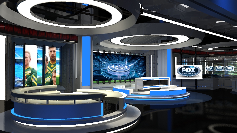

I have a file for you to check. I am still having trouble getting Kray to use the Lightwave lights. I have no idea why. I must say the glowing surfaces are making a beautiful light, but I need to produce TV studio lighting and need spotlights.
The scene I have here is a preliminary and only partially lit. I thought I should bask your advice before I proceed. I have sent you an email.
Phil
Phil

Thank you for playing with the scene I sent. Your renders are looking good - but!- when I open your scene all the lights switch off! AGAIN!!! I am finding this a real pain. I opened your amended scene in LIghtwave and your lights didnt work. I replaced your lights exactly and the they rendered in Lightwave but NOT in Kray.
Is it possible I have a corrupted version of Kray or something?
FYI: I opened the scene, removed all the lights except the "one you have to have" (switched off) and rendered a new scene. It looks okay but very dark. If I add a single light over the lounge area it wont render.... It turned the light up to 100% and still nothing. Its weird.
