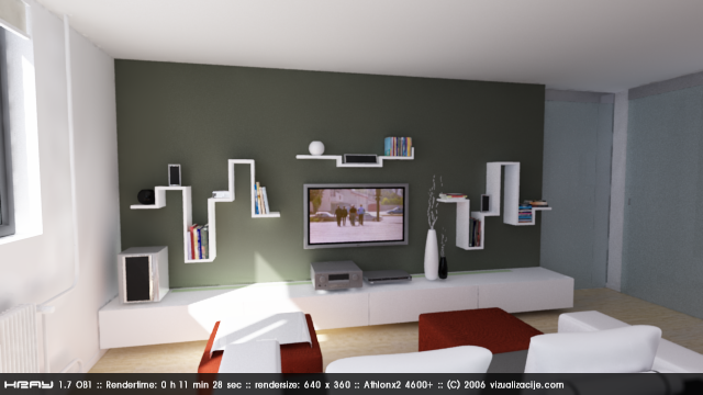

Soft sun shadows
Here's another tip:
If you'd like to get realistic Sun soft shadows you don't need to use Area light fo r it. Instead use Spotlight and in Kray "Quality" tab turn on "Spot to Area". Now to get accurate soft shadow angle it's best to set your Sun light 1km far away (you can do that quickly by ading SunSpot modifier) and then set your Spotlight Soft edge angle to 0.55°. This is because in reality diameter of sun is about 0.55°.
This way your sun shadows should look very realistic like in the attached pic.
Soft sun shadows
Here's another tip:
- 17OB1-00101.png (207.88 KiB) Viewed 89896 times

Soft sun shadows
Cheers, Florian
