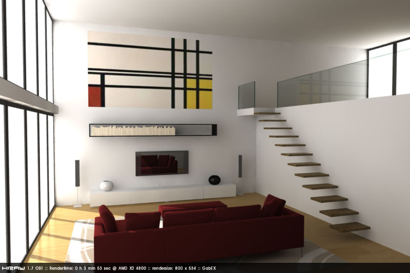

While you are searching your card :) here's my scene with a little bit different settings.
My "best lap" on an X2 4800+ is just under 4 min
--- thanks for this GREAT tutorial ---
final_G1.lws
(13.51 KiB) Downloaded 1096 times
