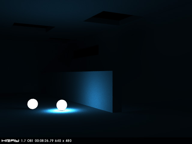

just a note : Kray instances can't be emitters.
(the ball to the left is an instance)
