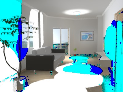

What happens? I put just a nice tree in my scene wich took me days to make fine,.. and then.. wen render it comes horrible colors. It mus be avery simple question for not new people in Kray like me, but I can't find an explication for that.
All suggestions are welcomed
Julian Garcia

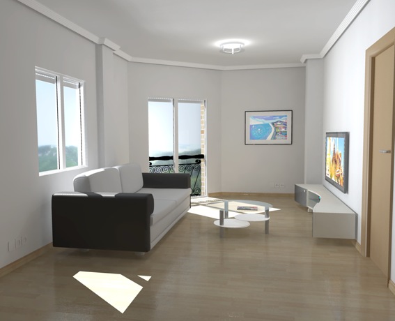

this suposed to be the nice one

Wow! I have no idea what that could be... Hmm... Did u by any chance use "Both" GI mode?
Otherwise try replacing surfaces on your tree with default gray and see if that's causing it.

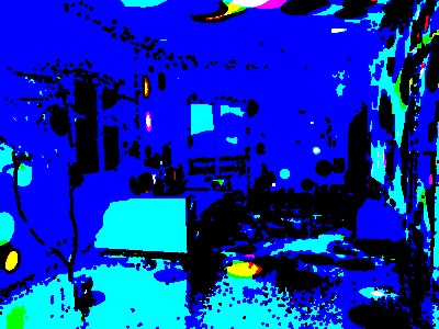

Good Idea, I will try it right know, have a look meanwile to the same scene but with photons estimated instead als photonmapping,.. it's a reaaly extrange case..
I will post the results very soon

You were right Jure, there was some problem with a texture in the pot of the small tree. I con't imagen a such a small surface texture can destroy a hole render scene...
Aniway it's good to know that sometimes happens..
Julian Garcia
Hmm yes.. It would be great if you could post the problem surface/object so we can kill that bug.
