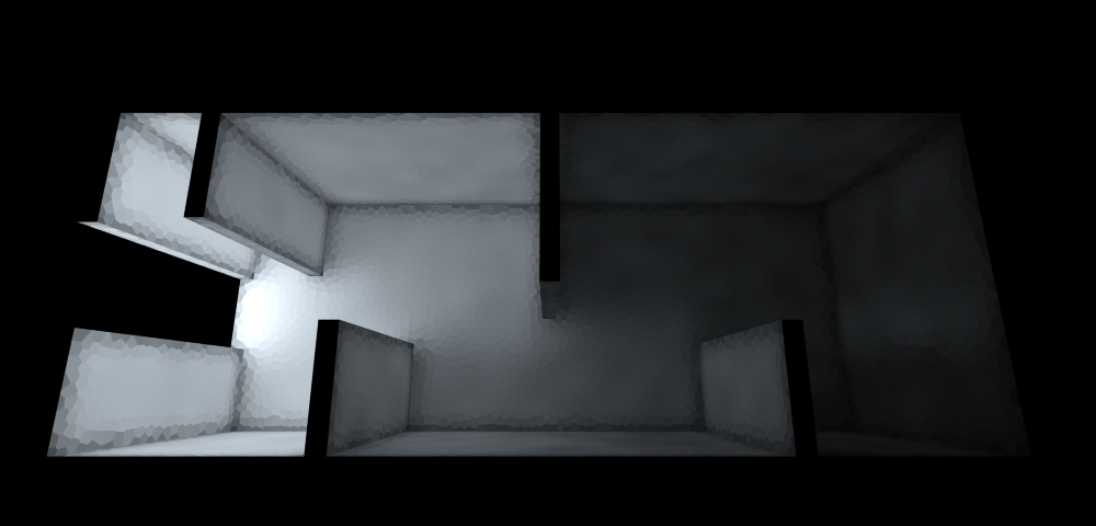

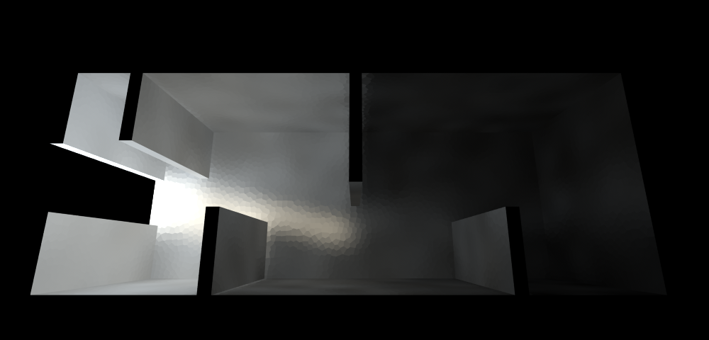

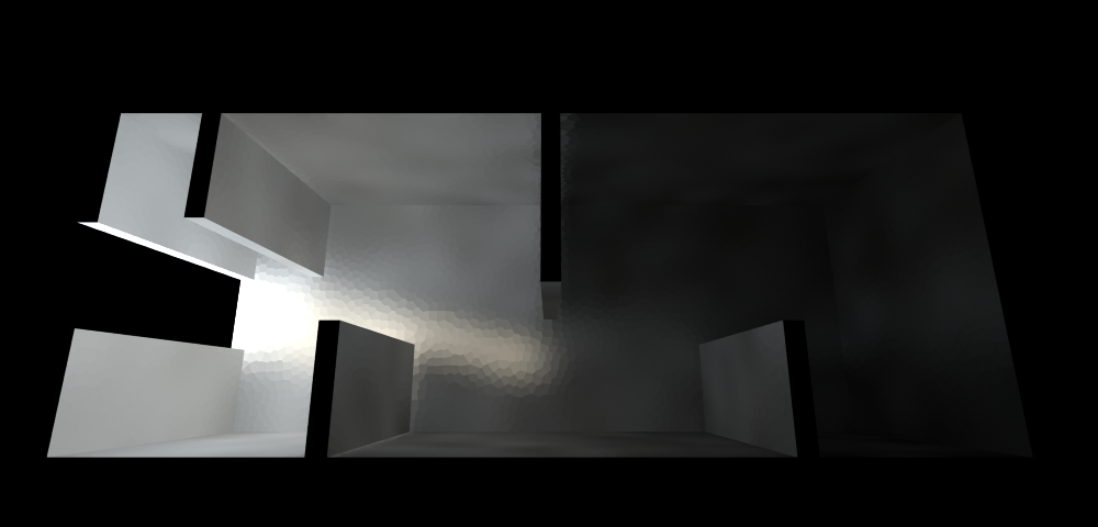

Here small test, how it`s work. You can notice very accurate corners, no splotches
and light leaks. The different is big but more bigger is You switch to Final Gathering - then render is much faster, much cleaner, light is better balanced, AA is even faster.
Skyportals works now only in Photonmap mode (must be lumi sphere as source of light)
To test normal mode without skyportals just switch to Lightmap.
You can see in renders big different between both method and how important are skyportals. Of Course when You use Path Tracing You do not need them.
Have nice test!
