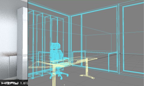

I'm trying to make a frosted-glass room divider using a semi-transparent plane and applying 10% refraction blurring but I'm getting poor results from Kray because the refraction blurring seems to generate huge amounts of noise resulting in a very grainy image.
I've fiddled with the Kray settings and the LW texture settings for a couple of days without eliminating the noise. I've tried photon maps, light maps, high FG settings, low FG settings, lots of photons, very few photons, etc etc etc. I've also used a thin cuboid instead of a plane. No luck.
Does anyone have any experience using refraction blurring with Kray? Is it even supported properly at the moment (1.612)?
Cheers,
Phil

Here's a screenie of the scene, with a bit rendered to illustrate the problem (no AA). I'm using lightmapping, the background is white and the model is open behind the glass, so there is effectively a light source behind the glass I guess. It'll take some pretty fearsome AA to smooth out that noise though!
GI Res 1m. 500000 photons received, N=500.
FG threshold 0.0, Min rays 2000, max 0.
No irradiance cacheing.
Boosting photons, N, or FG min rays doesn't seem to help.

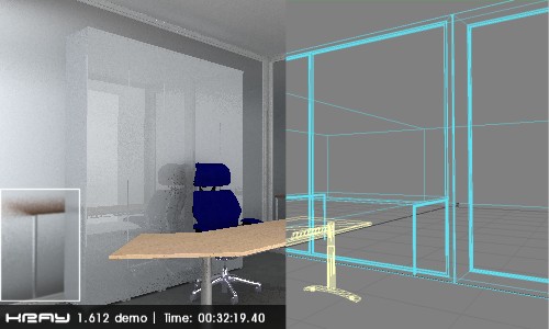

Progress!
Post by phile_forum »
Yes, I did try photon mapping and, as Jure says, it didn't help.
However, Jure's remark about light sources behind the glass being problematic gave me a new angle of attack. I built a wall behind the glass, painted it white and bounced a light off it. The result isn't perfect and it still needs some tuning, but it is a big improvement. Here's another pic. Most of it is rendered with FG rays at 1000 and no AA, but the bit in the white box is rendered FG 2000 and AA fullscreen grid 3 cone 1.5 radius.
hmm much better, yes. Here's one more idea: try using limitdr 1; tailer command - maybe that will get rid of noise. http://www.kraytracing.com/manual/kray_ ... hp#limitdr
btw. AA radius 1.5 will blur alot your edges. 0.5 is optimal. But if it works good on your glass than go ahead with it.
