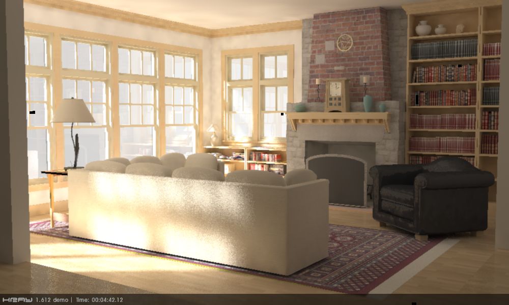

Hi all,
First of all, I'd like to say that the info on this forum has been very helpful in teaching me how to use this render engine.
Here is an old scene that I did in Lw6. Can anyone explain what these artifacts are? The scene mostly (if not completely) single sided quads. It is lit with an area light and luminous polys outside the windows. I used 10 bounces and full screen grid AA. I can provide more info if needed. Thanks in advance :)
I think this is a bug related to using "Both" gi mode and/or undersample..
Try without any undersampla and do not use both for rendering stills.
let me know if it helps...
cheers!
daug

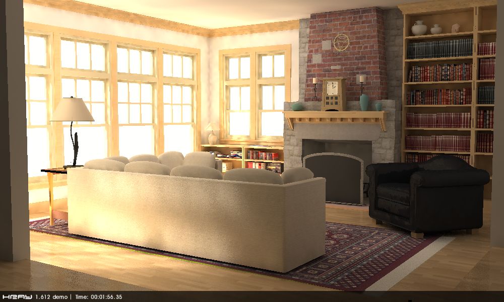

Hi Jure,
Thanks for the reply. Here is a render with undersampling turned off showing the same problems. Actually I turned off AA completely also. Any ideas?
Oh, and to piggyback on my own thread, how do you get your images to be so bright and vivid? I'm having problems getting secondary bounces to brighten up the room. When I turn up the lights or multiplier, the light coming through the windows is way too strong. When I adjust gamma, it washed out the image (see the image posted. The black chair isn't black). I'd love to hear some of your tips :)
Did u make sure you're not using "Both" for GI mode?
Also sometimes bad UV's can be producing such artifacts (overlaping uv's...).

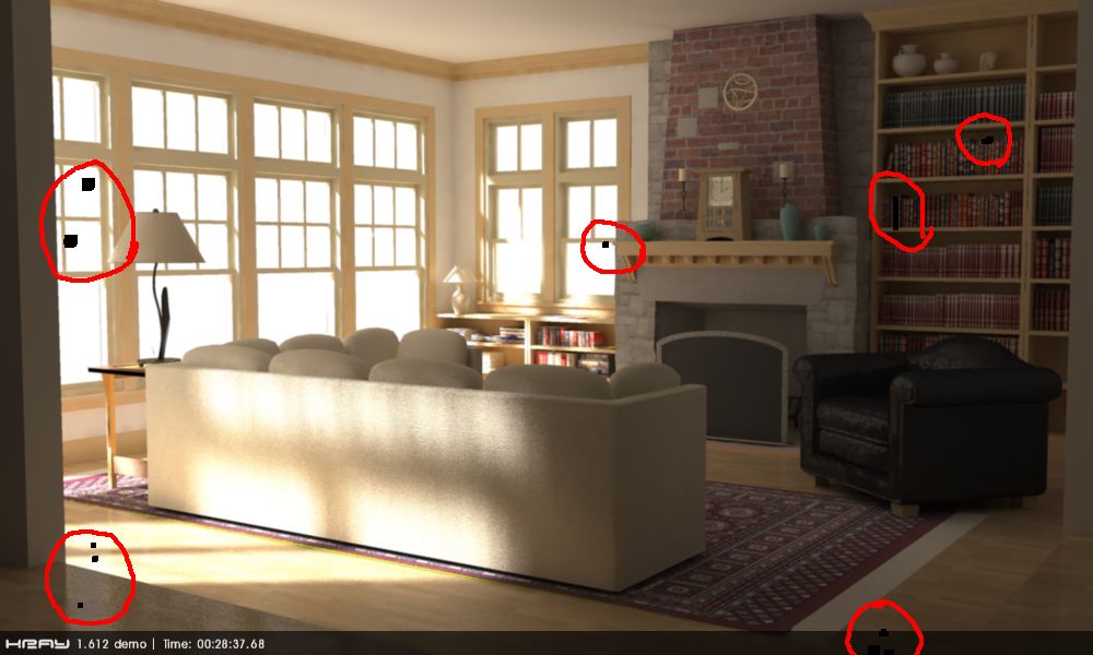

found the problem object I think....
Post by daug »
I removed the glass from the french door and the windows and the black splotches went away. hmm.....
I'll have to look into why the glass is doing that. Any ideas?
