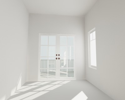

I'm currently working on my first animation using KRay. I've been reading the Learning Page and most of the info there mentioning turning FG Passes to 1 when rendering sequence.
However, turning FG Passes to 1 makes the splotches and lights leak too appealing.
Any advice on the proper step by step to animation rendering on KRay plz?
If using FG Passes to 2, will it slow down the next frame rendering due to more samples collected?
Attached is the sample rendered:

Well You need knowledge how to do (in K3.0 I have plan to make one button setup for all procedures in animation case)jonathlee wrote:I'm currently working on my first animation using KRay. I've been reading the Learning Page and most of the info there mentioning turning FG Passes to 1 when rendering sequence.
Here my Skype contact:
biela1972
Will explain how setup it. With i7 CPU You can render this scene and resolution under 1-2 min/frame...but of course with correct setup

You can use more than one pass but set the frame step high enough so that your FG samples don't duplicate frame to frame.jonathlee wrote:I'm currently working on my first animation using KRay. I've been reading the Learning Page and most of the info there mentioning turning FG Passes to 1 when rendering sequence.
