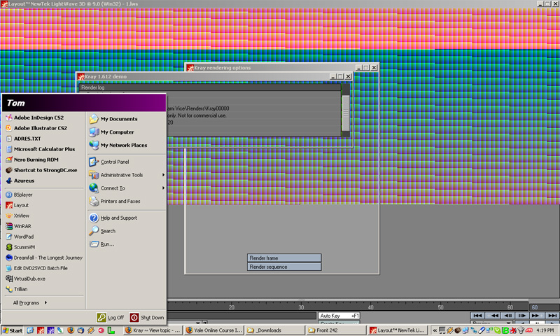

This time however, as soon as the 'octree' comes on, my screen garbles partially, I get another unexpected exception, and it exits.
Screenshot of funkyness attached. It returns to normal once Kray is closed.
- kray_crash.jpg (229.64 KiB) Viewed 11188 times
This object caused the first unexpected exception.
