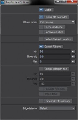

I guess i have a little too much time on my hands :) kray can render trees and grass with reflection and reflection blurring values (with applying kraysurface options) very fast but lw's renderer takes just way too much time for rendering the same scene. what is the difference between kray and lightwave's native renderer?
Re: kray vs lw
Well kray has very fast GI, much faster than LW. Also raytracing reflection blurring is much faster in Kray. I don't think there is much you can do in LW to achieve that. I think you should search newtek forums to find out how to setup materials to make them render faster with LW.

Setup this shader for grass :wink:

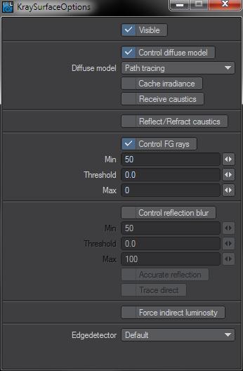

thanks but ...
where do i have to apply the shaders... just on glass surface or on all surfaces?
if i have to apply this shaders an all surfaces would be a very long process!
Just for grass, or trees or anything that's really small like hair/fur...

but i dont have any grass ... i just have some glass!! ( lamp one behind the other)
perhaps u mean that because of high recursion limit i have to reduce fg rays on small object in order to have the kray go faster?

giacob wrote:but i dont have any grass ... i just have some glass!! ( lamp one behind the other)
For glass minimum recurse is 12 imho. Do not use lower value. Glass need a lot reflections to look good....and this You can not over jump. Try Dielectric Node , is very fast but I think buggy still. Here Node maybe will help You. Generally glass is always big problem and until when Grzegorz will write special shader for glass for Kray will be all the time problem....
