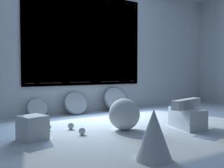

Here is your room again Alex. The mainproblem with the scene was that no walls had any thickness at all.Every photon/lightmap renderer needs this thickness otherwise it goes crazy and dont know where the photons goes.
try the scene and keep on experimenting from this basics. If you want a backdrop/image to cast photons, add an image to a plane and put the plane outside the window and turn up luminosity until it looks ok.
/Silver

what a great man you are .. :wink:
you helped me alot
and this cummmunity is great also :D
thanks silver
never found a helpful place other than here
