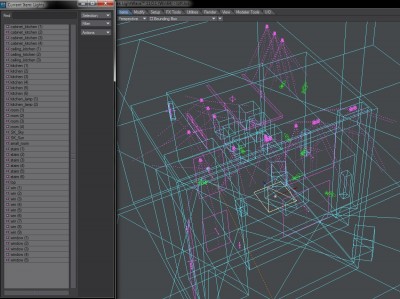

Here setup light (no lumi in scene). Time renders between 1:30 - 2:30 h.

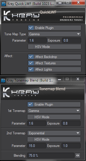

Re: ambient

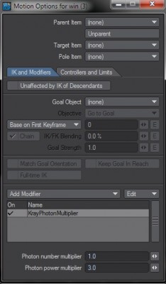

About lights:
1. there a lot of spot and area lights, why? because I was tired by exponential tonemaping and "its" let`s say "patronizing" over scene (we know how exponential can ruin render...and we know we can not live without exponential) so I took decision to reduce level of exponential. So from now I will render almost pure LWF Gamma (in these renders are 75% of LWF in blending shader) If I will put just a few sources of light scene will start be overburn and flat. Is very hard control LWF but LWF brings positive thinks with real view of colors.
2. Actually this amount of lights did`t affect strong time of render (15-25 min without AA) but complicate setup of surfaces, high level of blur, high level of AA give multiply minimum 3.
G. promised better AA in next release and also surface shaders (which really bring speed)
3. Is one trick which I used first time: PowerShader for lights, because was too dark and could not use strong exponential or just rise up brightness of lights I make tonemaping by power (2-3 for each light) This idea can be DEVELOPED. Of course somebody will ask why not do it with lumi panels, but I observe power shader works better with physical lights. Are less splotches (almost non), less effect of strong radiation.
4. I would like really avoid problem with exponential by canceling unfortunate exponential and use only LWF Gamma. But I think this is quite difficult and maybe PowerShader can help to control better LWF Gamma.
Will continue this way and we will see what we get

Re: ambient
There is more clean info about tonemaping and PowerShader.albertos2008 wrote:Hi janus..
what you have write before is chinese language for me..
Re: ambient
That is what I tried with my last renders, but do you set up parameters in LW in LINEAR or RGB?
Also, around ceiling it's pretty dark, hox do you handle that?
Re: ambient
Yes, in LW must be Linear. All space colors and tonemap You do in Kray .khan973 wrote:That is what I tried with my last renders, but do you set up parameters in LW in LINEAR or RGB?
