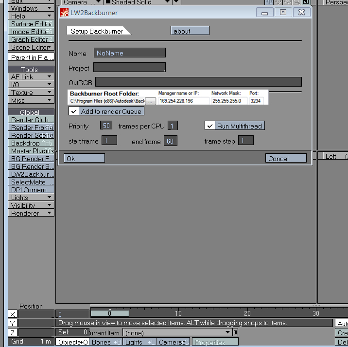

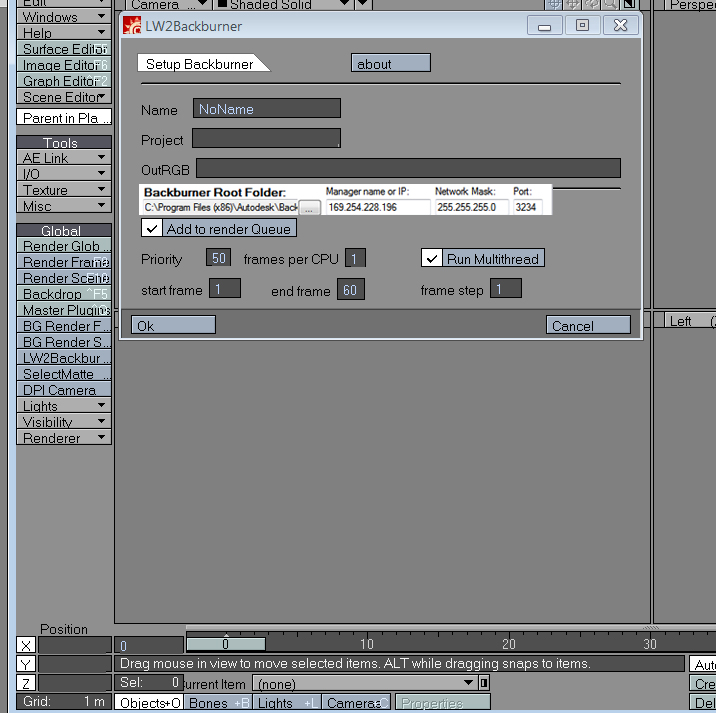

Wonder if its possible to add the parameters for the ff: backburner root folder, manager IP, etc like in the attached pic.
I'm using an AE script with backburner that has those parameters and easily adjustable without having to edit the text file.
Backburner is free btw. I wonder if kray should take advantage of this and use it as a network controller.

Yep it's all possible. I just need to spend a bit of time with it. Here's the script i forgot to attach.jnom wrote:I don't see the script.![]()
