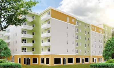

In green zones, i want to see better the lines.
Re: Details
Alek6 wrote:In green zones, i want to see better the lines.
Make color of texture lines darker.

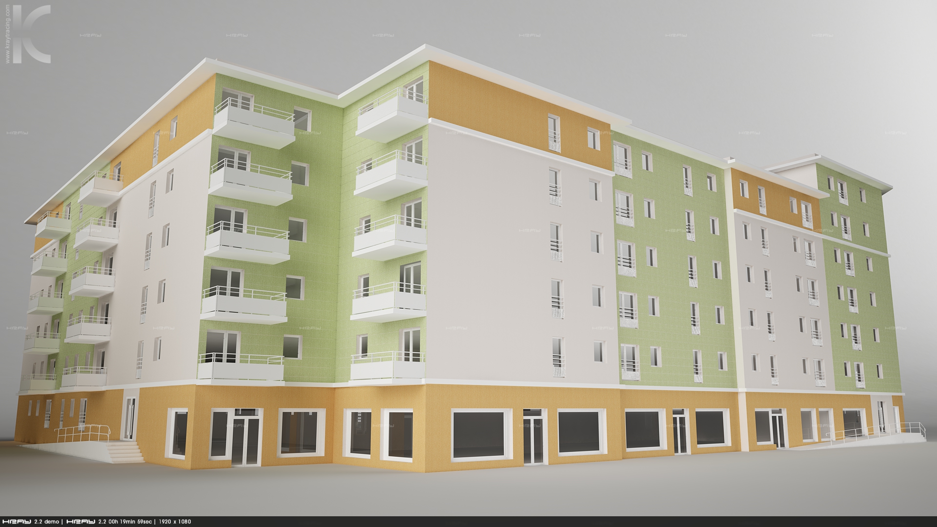

Ok, i thought that i could do it with a different light... i'll try this solution
Re: Details

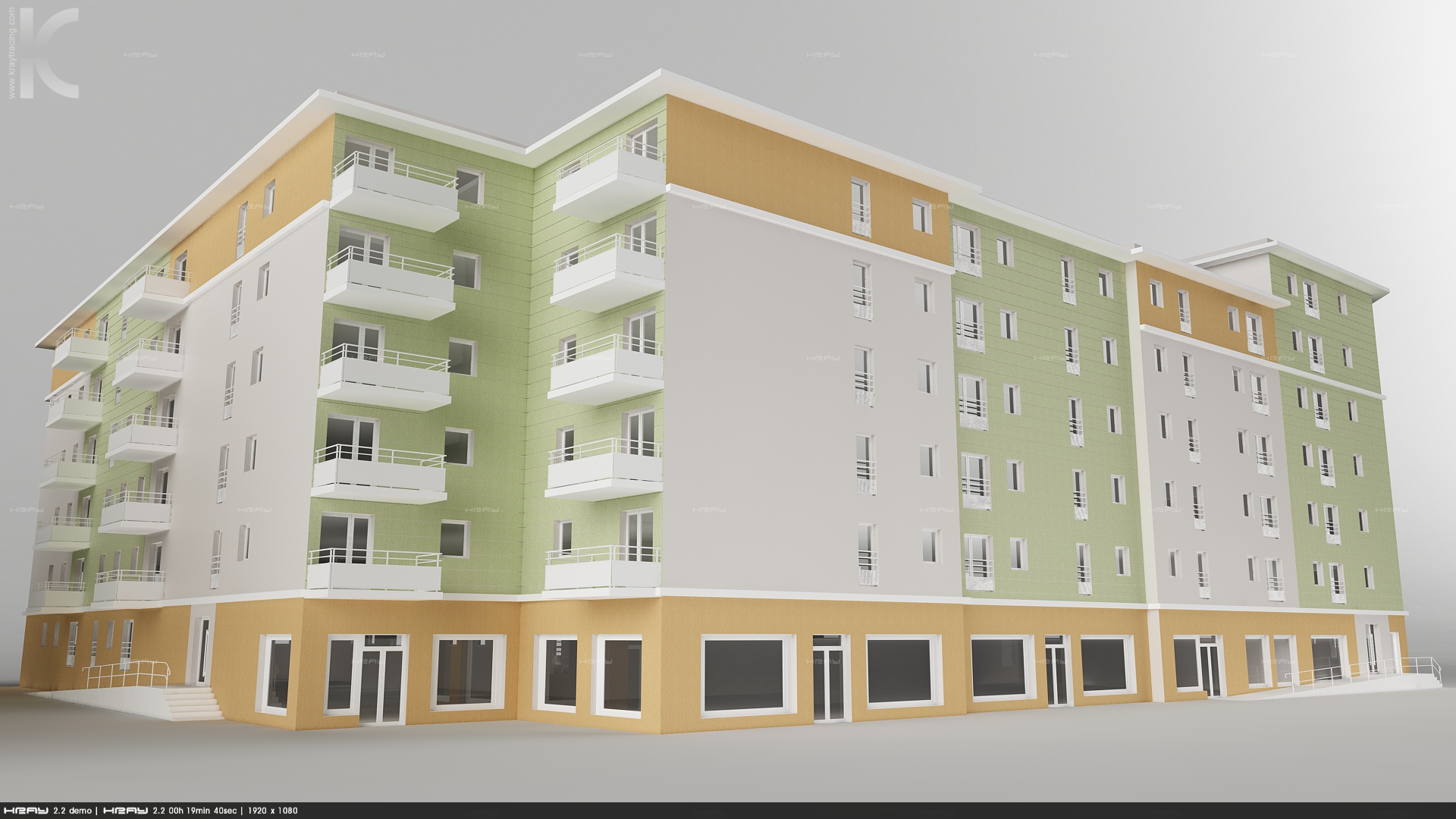

You need a bit complex texturing (good diffuse map minimum 2000 pix seam , reflection map, and bump map created by NODE Normal net...in attachment)
Do not forget for exteriors white color maximum 80% diffuse....
One more think .... camera: ONLY SHIFT CAMERA for exteriors.....

Re: Details
Post by Alek6 »
It's better but not much

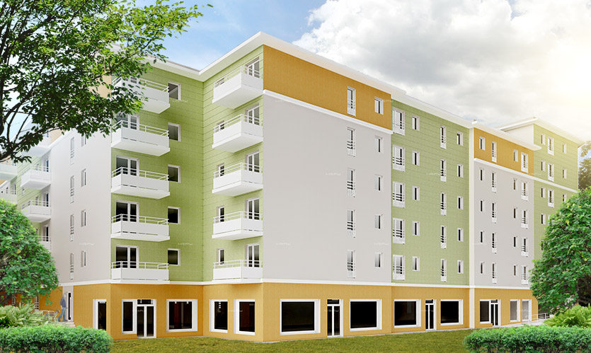

I try make fast PS for that. Contrast is very bad (You have bad tonemaping and setup of surfaces) Remember exteriors are difficult and render buildings without environment always bring bad contrast . Trees, trees and trees this You need to hold photons....
btw I hate clip maps....
