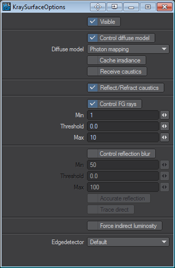

Did you assing Kray surface options shader to your trees materials and turned off caching irradiance?

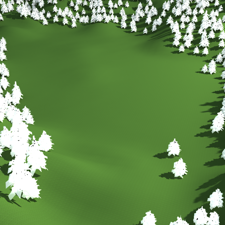

Hi Jure,
Yesterday I reduced the tree models to 500 polys each (down from 2500) and it actually rendered and didn't crash; however, it took 8 hours to render and when I arrived at work this morning all the trees were messed up; they were bright white (see attached image below.)
I did not know about the shader options, I am trying it with the full-poly trees now with those applied, and Cache Irradiance turned off. I clicked render about 5 minutes ago and it seems to still be stuck at "Rayracing in Progress (768x768)" Do I need to change any of the shader options settings? Is there anything else I can try?

Something is wrong with your object. The shader for the trees must be set like this:

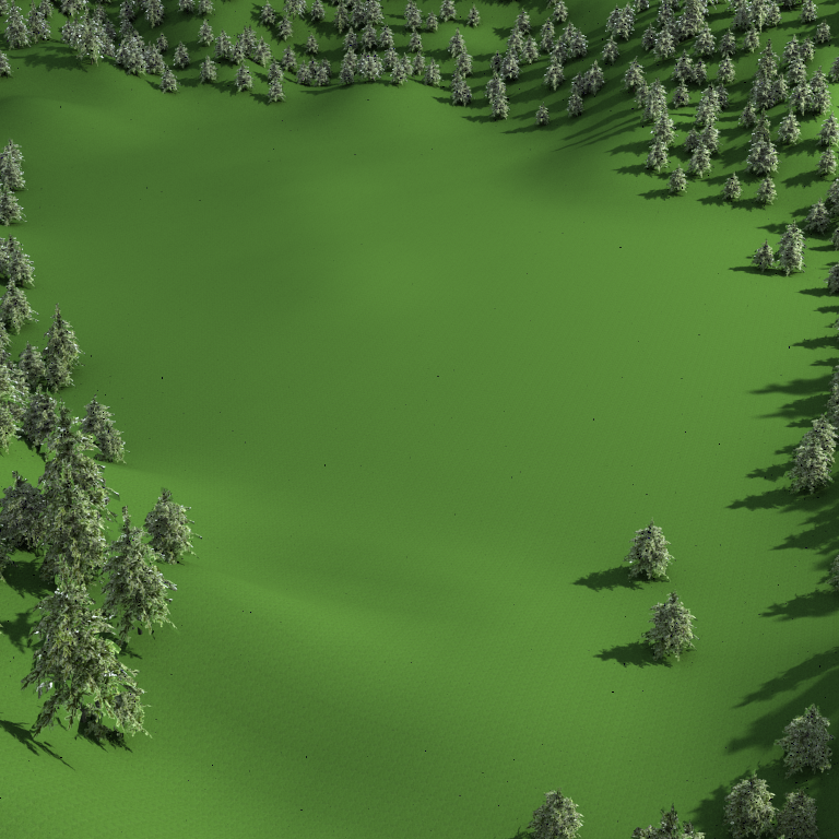

Hey again Jure,
Thanks for the reply. That last render worked, took about 12 hours total. Below see the finished image!
The only problem? My boss wanted more trees. So after doubling the amount of trees and leaving it to render for a long weekend (from Friday to Tuesday) I'm back in the office today & the render STILL had about 4 days 4 hours estimated remaining? So there's still a problem apparently...
Would uploading my full KRAY settings help? What else could affect render time so much? It pretty much locks up at 0% again... not sure what to do!
Thank you again for all your help!
