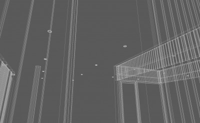

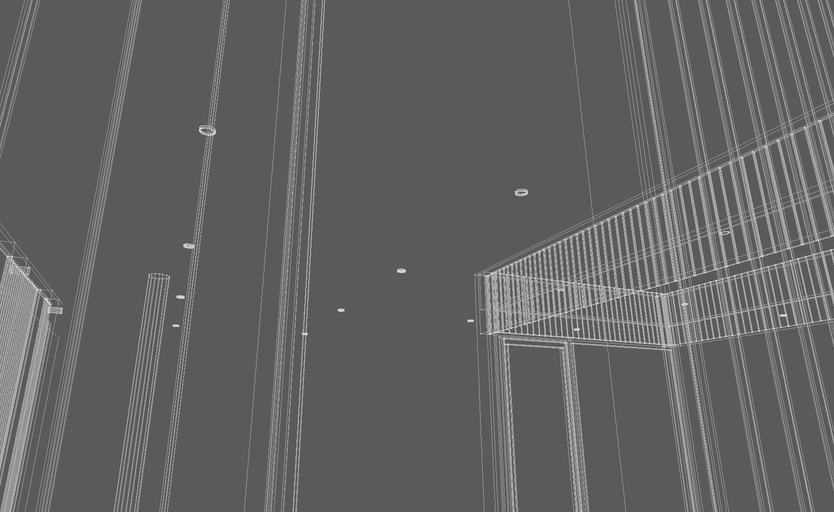

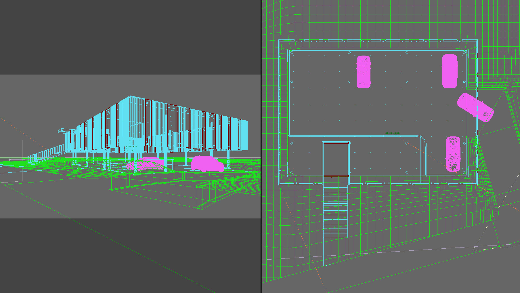

posting these wires, one is scene in layout, other is model closeup ceiling.
						Re: Lumi noise
hmm strange, i don't see anything in those wireframes that woul cause the noise. Perhaps you could isolate part of the scene and send it to me to investigate?

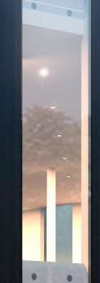

						Re: Lumi noise
To me it lloks like trees reflected on the glass
				darickster
- Posts: 64
- Joined: Wed Nov 28, 2007 10:39 pm
- Location: NL
Re: Lumi noise
no, i am referring to the white grain around the spots as seen in detail.jpg
