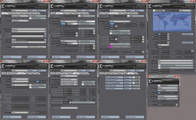

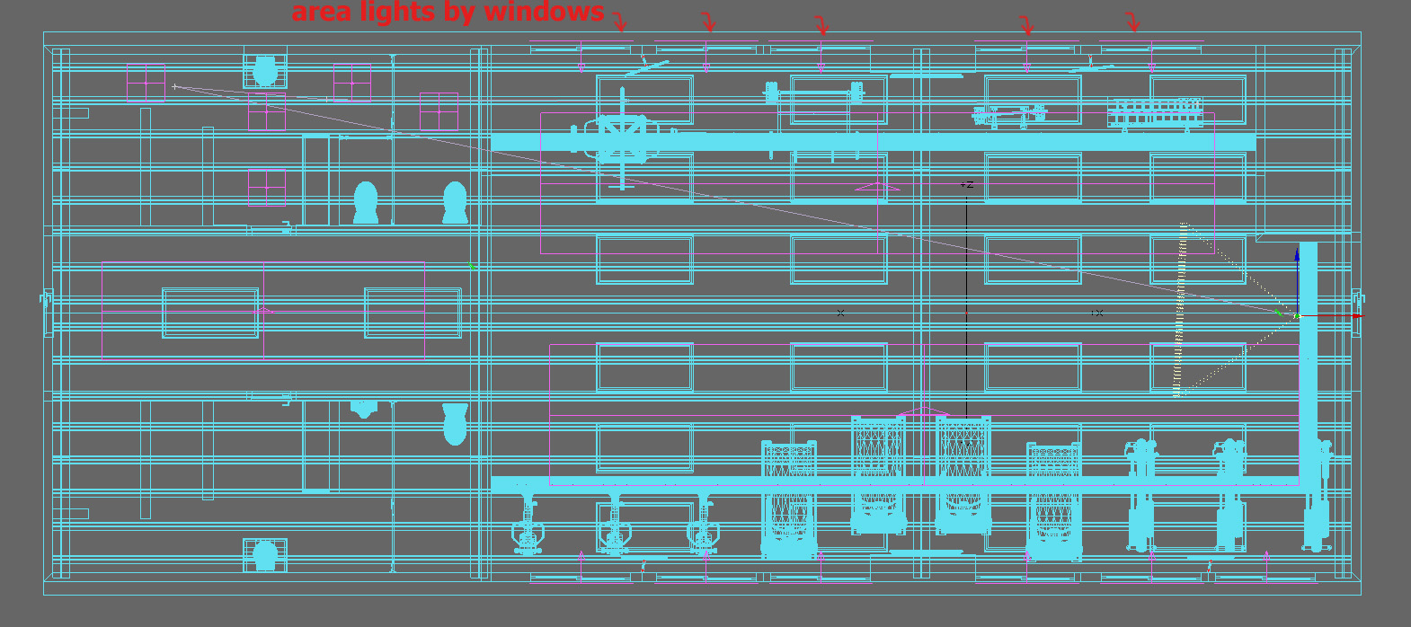

I've got an interior scene that seems to me to be rendering very slow for Kray. And I've got to do an animation for the project. The render times are around 13+ min at a 720 x 400 resolution on a 3.3GHz six-core machine. I've tried using luminous polys to light it (you can see those in the attached image) as well as (not at the same time) the large lights scene via the top view. I've got area lights at each of the windows which have been on when I use lumi polys and the large area lights. My settings are pretty basic (see below). Any quick help on this would be greatly appreciated.

Have you tried to light it with only lumi polys? Lot's of area lights can make render time quite slow. Also check with Kray override if reflection is maybe the cause of the problem.
Also if your going to animate it you need to set "passes" in FG tab to 1.

HUGE improvement in render times!!! Dropped to just over a minute! Thanks so much fellas. It's definitely blotchy compared to the previous renders, but I'll search the forums on how to clean that up. I'm trying to model more in modo, but dang I'm still enjoying Kray. Big thanks again guys.

Larry in PHOTONS PANEL Caustic preset insert LOW (NO MEDIUM) Caustic photons 0
> GLOBAL PHOTONS 2000000
if you need + lighting = power 2.0
IN FINAL GATHER PANEL FG Thereshould min 200 max 800

Thanks Nico.
Re: slow render times ...need help
Caustics are not enabled so this won't make any difference.nico wrote:Larry in PHOTONS PANEL Caustic preset insert LOW (NO MEDIUM) Caustic photons 0

oh i've see now general tab attachmentjure wrote:Caustics are not enabled so this won't make any difference.
