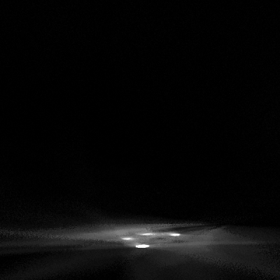

						Re: Kray 2.4 released
This is example. Kray render is noisy and splotchyjure wrote:What do you mean you can't get smooth shadow pass? Can you show example?jnom wrote:Thanks for the update Jure.
You can control quality of area lights in Kray Quality tab. Increase min/max recursion setting.jnom wrote:This is example. Kray render is noisy and splotchyjure wrote:What do you mean you can't get smooth shadow pass? Can you show example?jnom wrote:Thanks for the update Jure.
Testing the shadow density now. I notice its hard to get smooth shadow pass in kray unless you do full pass AA. Rendertime is pretty high.
Yes but this slows down render time a lot. the value from 3-4 makes big jump in quality and render time. And even at 4 there's a lot of grain/noise that can only be cleaned with full AA grid 3,4.jure wrote:
