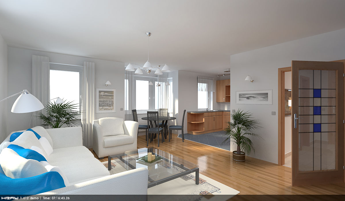

First render. Next will come soon :wink: . I appreciate your comments.
Very good!
First render? :)
Use Skaydome or Area lights?
cruisermori
Posts: 98
Location: Czech Republic
Post by cruisermori »
Thanks. First final render from the Bungalow :) I would like to present here. I have GI plates in all windows + area light as sun and area lights from the ceiling.
Posts: 453
Post by silverlw »
Not that i criticise the image, it's very very nice, but why do you need GI planes in the windows? The overall light in the room is perfect and the materials look god.
cruisermori
Posts: 98
I need all these GI plates to make this overall light in the room. I tried to use GI as a ball around, but it produce a lot of splotches. Myabe wrong set-up :? I have to test some other scenes if it works well. Also render time is still to long.
Yep I "boost" light from windows (add area in winows) My style is slow but nice quality (panels make very speed render). I use GI from double ball+Area.
Great work Cruiser! You sure crancked up the settingse, hence the long render time.
Btw. your curtains are hanging in the air. :)

You are right Jure. I was really focused to the KRay set-up and I forgot cornice for curtains :) Next time it will be repaired. Thanks.

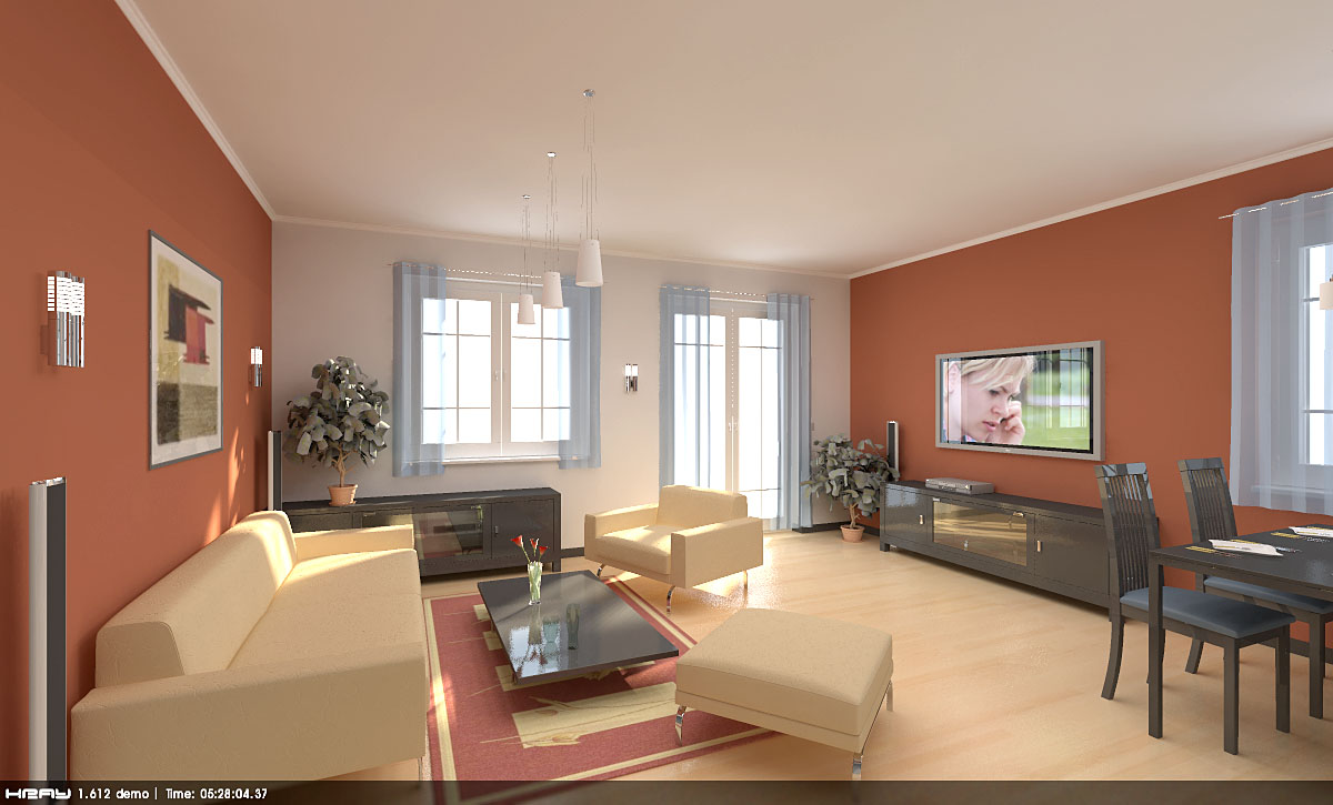

Hi all. Next render I just completed. It isn?t flawless (clip maps on rubber plants don?t work, some issue on the red wall) but lighting I assume is acceptable. KRay is amazing.
CruiserMori wrote:Hi all. Next render I just completed. It isn?t flawless (clip maps on rubber plants don?t work, some issue on the red wall) but lighting I assume is acceptable. KRay is amazing.
Yes Kray is amazing.
You talented.
Must fix time render. 10 h is too long.
Show light position on wire.
What CPU?
Great work Cruiser! Yes clip maps don't work with Kray. Use transparency instead. Also double sided surfaces appear only single sided so you'll need to make your leaves double sided geometry also
Keep em coming!

Great renderings, i would only increase the contrast in PS, otherwise they are excellent. If only AA would be better....
