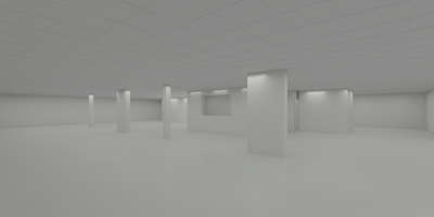

hi boys, i've problem i need to lighting this room.
there isn't windows and the effect with lumi panel isn't good (ithink).
i want a global lighting but is very difficult
who can help me ad sharing the scene? :oops:
share.zip
(92.93 KiB) Downloaded 382 times

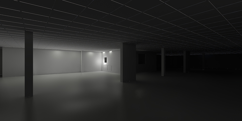

You can iluminate with lumi panel withouth problem.
I dont know what you need, about artificial light... add light where you need.
This is a fast test only adding more power multiply and photon multiply.
You can control thiss easy.

Accordling to your ilumination.
If need to iluminate dark zone is better adding more lumi panel for realistic results.
And you have problems with the mesh... ;)

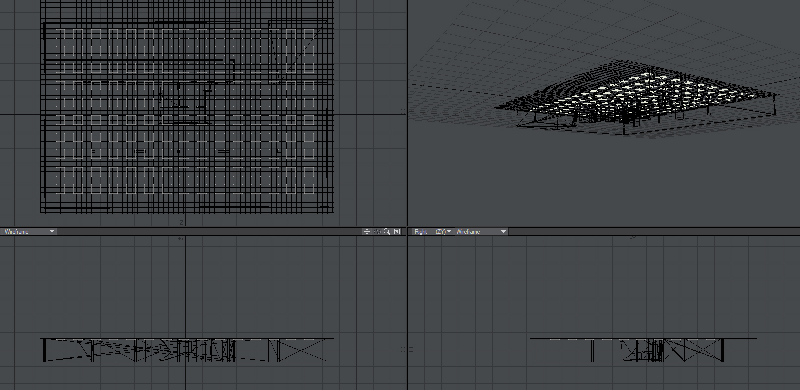

zohan you can post a a wire frame for see your distance panel :?:

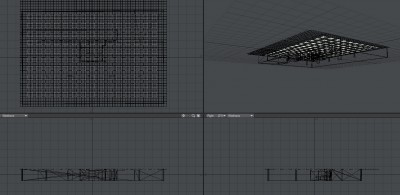

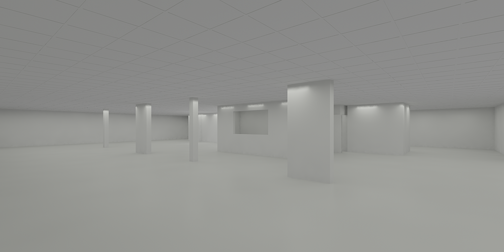

i've tested using a grid plane with plane as lumi.
see the attachment but i think the lumi need a correct position into the space.
this is a fast test but isn't good...render time 19min and lighting very flat.
it's important move lumi panel one at time
thomas
Posts: 348
Re: lighting this room
Post by thomas »
I don't know what size you're rendering at but a render like that shouldn't take more than a minute one medium setting for 1000 x 500 pixels - give or take a bit, but 19 minutes, no. Maybe you have a liiiiiiittle bit of (blurry) reflection on all your white walls? If so, just set this to zero.
Then another tip for your lighting: filling up the whole room with completely evenly spaced lumi-panels will give a very dull image, as it should do, because if practically the whole ceiling is a luminous panel with constant lightness then there will hardly be any shadows. Try putting only 10 to 15 panels that are smaller in size (50 x 50 cm, for instance) just to get a feel for the difference in lighting - you might have to crank up the luminosity to 5000 percent but that doesn't matter, as long as it looks good. Filling up a whole space with a very regular grid of luminous polys has always produced boring images for me.

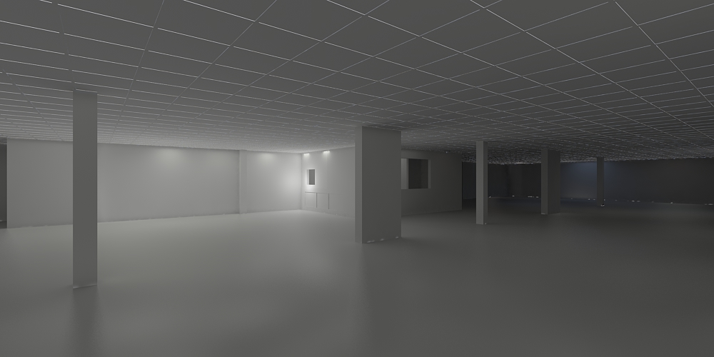

Post by zonah »
Nico i not change nothing in your scene, is all same that you share.
I only add Kray photon multiplier to your Lumi object and too i add soe indirect light on floor shader to increase bounds and take more light.
