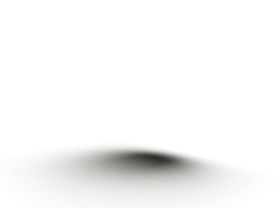

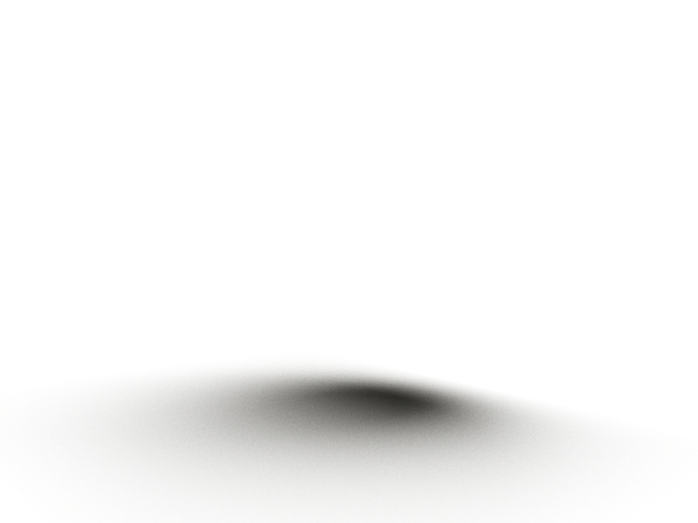

Is shadowdensity supported in 2.3? Or only constant value? It would be great to have a mini update that would include support for shadowdensity. I included the sample scene. I usually render out moving objects separately as well as the shadow from the main bg render for flexibility and shadowdensity or a shadow catcher is needed for this. Kraybuffers can see direct and indirect light but can't separate out the objects that cast shadows from other objects.
I've tested 2.3 with different render modes with unseen characters,etc with bones and it works fast unlike older builds where there are errors and renders slow. Whatever you guys did its great.

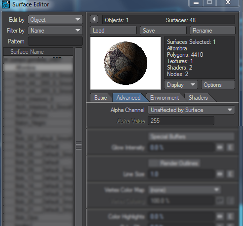

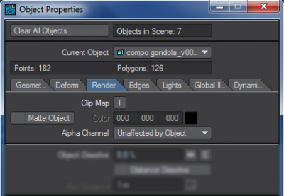

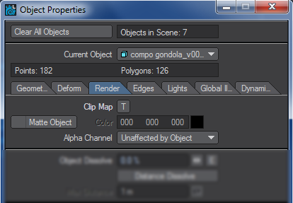

jdomingo about new Alpha compatibility you only need to setup your objects same that in LW.
I do a little test and work fine.
You can set Alpha channel per object or per Surface.
1.- Per object: In Layout open Ocject Property , Tab Render, and select unaffected by object. This exclude this object on alpha.
2.- Per Surface: Open Surface Editor, Advanced Tab and set Alpha channel Opaccity with a value or unaffected to exclude.

Well some image here, i cant edit my msg
OBJECT
SURFACE
SURFACE

Anyone check this? Old fprime supports it. With alpha matt support and this shadow density surface support, I would say kray is complete for animation. I can render the bg in 1 pass. Render characters in 2nd, then render out shadows in another.jnom wrote:Is shadowdensity supported in 2.3? Or only constant value? It would be great to have a mini update that would include support for shadowdensity. I included the sample scene. I usually render out moving objects separately as well as the shadow from the main bg render for flexibility and shadowdensity or a shadow catcher is needed for this. Kraybuffers can see direct and indirect light but can't separate out the objects that cast shadows from other objects.
