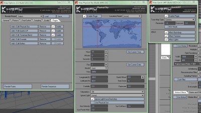

I have been trying to get this room to look better( brigher..clean white )but stuck!
Because there are now windows I ended up putting lots of spherical lights and lumi panels.
any advice on how I should set this room up?
I am uploading my files and my settings.
sorrry im still trying to learn.

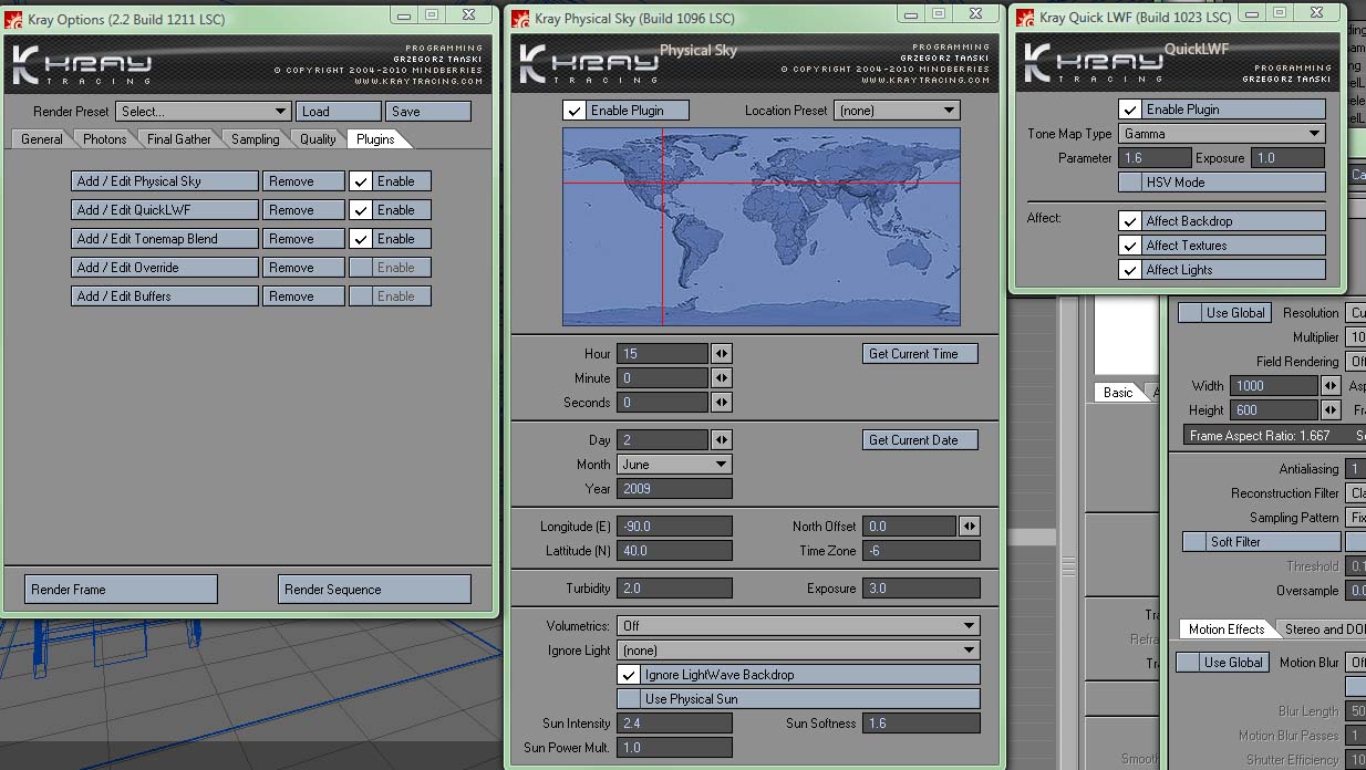

1. Turn OFF Physky (why You use this when You do not have windows?)
2. Everything is ok when I see render (I think You should setup TONEMAPING better)
3. try render with QMC (no interpolation for Gi) so shadow will be perfect

Oh, I have physky for some other parts of the building

Janusz : I am having little trouble with tonemapping.  I keep getting washed out look.  Any advice?
Re: little help? with lighting this room.
You can try just basic setup, exponential from first tab of Kray.xhd2xhd wrote:Janusz : I am having little trouble with tonemapping. I keep getting washed out look. Any advice?

Janusz Biela: I used the tone mapping like you said and I think it looks muc better!

what means QMC (no interpolation for Gi)?Janusz Biela wrote:1. Turn OFF Physky (why You use this when You do not have windows?)
what settings should I use?
Yes QMC = Cache irradiance OFF. Photons settings are the same you only need to check FG rays min/max setting. Other settings don't have any influence in QMC mode.
