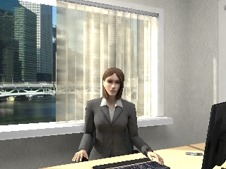

Here is a screenshot I did today already. It was done with a bake of the character alpha'd over the background. As you can see there is no shadow over the table which I thought I could do by rendering out a white version of the table with a light creaintg the shadow but not getting the right result yet. Will keep at
- Test.jpg (32.04 KiB) Viewed 12747 times
Yes setup a room without a character and bake the GI only to texture maps... Then render out spherical panoramic image of your room which will serve as a lighting image for the ASA_FakeIrradiance plugin (you'll need to convert spherical map to cube to work with the plugin i think).
Then set up your scene with bake maps in appropriate channels. Add couple of area lights to affect character so it'll cast shadows and add ASA_FakeIrradiance plugin to character...
Hope that works for you!
cheers!

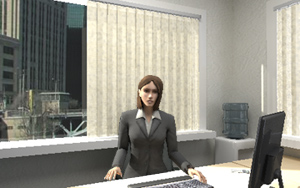

ok here is a render of what I have just now. It takes 2.3 seconds to render which is a million times better.
However I cannot get the shadow from the character but I don't know if I am doing the luminous map wrong. I back out the GI to an hdri with surface flags 1 to get the GI. I then load it back in to the object and put itin the lum channel and set it to multiply. I then have to turn it to 100% to get it looking the same. The problem I have is when it is set to 100% I cannot recieve shadows on my objects. Have I applied the 100% correctly? I also have to exclude lights as it becomes over exposed which is also the reason I can't see the shadow.
I also could get the colour of the character right with that plugin. I baked an HDRI shperical map as suggested and then applied the plugin and tried the different settings but none of them recreate my original render so am not sure where I am going wrong. The image below is a baked character texture map so unfortunately the lighting won't change as it moves. Also there is no shadows on the table.
AM I trying something that really can't be done in the one pass?
- 01.jpg (67.3 KiB) Viewed 12708 times
