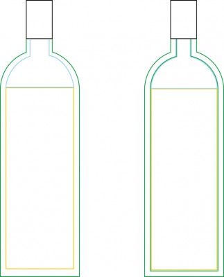

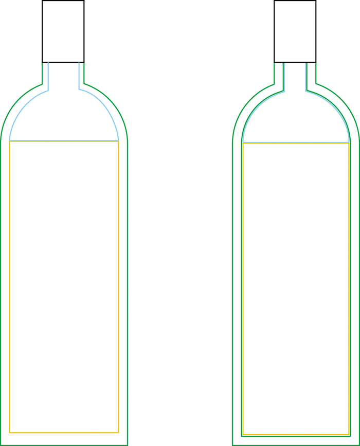

p.s.2. So what is the new way to do glass, without the air polys then? I've uploaded a JPG with two setups. The left one makes rays make a transition from one material to the other, the right one makes a ray 'exit' the material it's in before entering a new material and probably letting it enter a tiny tiny tiny space of air before entering a new material. Which one is correct now, for Kray and LW? Also, do I leave a tiny airspace in between masses (between glass and wine, for example), or do I let the points coincide? And if I let the points coincide, can I merge them? I always seem to have a lot of problems with internal reflections, way to bright white areas and noise when I do setups like this...
Thanks for any help / info!

Re: Wine bottles
Thomas, let's try with something more... easy.
The best way (in my opinion) to get a perfect glass is the following: build a sphere, now build a second sphere a bit smaller than the first one. Place the second inside the first. You're done!
Assign a clear dialectric to the first ball and a coloured dielectric to the second. Don't forget to assign a proper IOR.
Let us see what you get
Re: Wine bottles
Yep keep it simple.
Outside bottle make regular glass material, inside bottle cut the bottle at the height of the liquid and make it liquid material. Done. No airpolys no air space, no double geometry.
