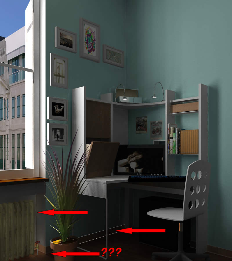

Hi all! I usually make rooms with 'box' command with 'radius' =< 5mm and 'radius segments =>3.
I make windows and doors via boolean operator, everytime I use the merge points and unify poligons commands (even if often this is with no effect).
Do you know what's the reason why the render makes these surfaces very shiny? Along the line where the walls join themselves there is a luminous straight line wich I can't imagine how generated.
The artifact appears to be indipendent from the amount of value in reflection and/or diffuse channels.
Oh... lines only appear after the last render step.

Could You show render?

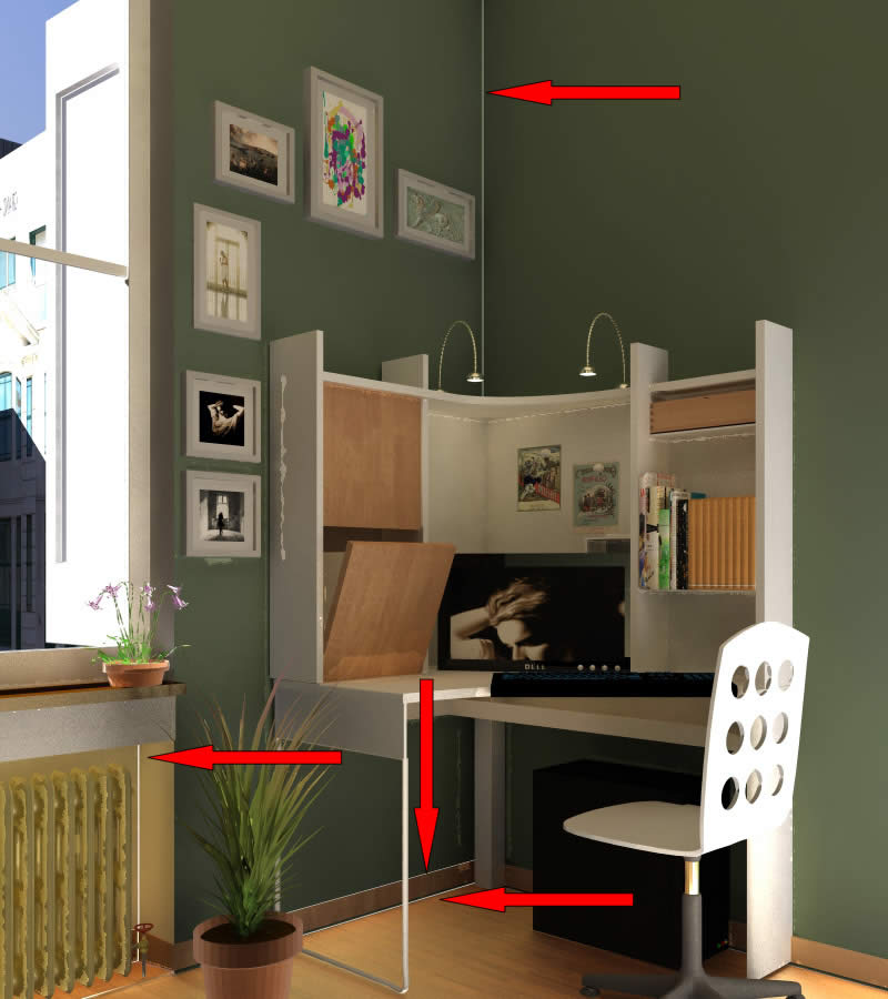

here they are. There are some adjustments from the first to the last one, but the problem... flies around... :)
I suppose it's a problem of geometry... ?

weird. could you send your walls geometry? I never use rounded corners for walls though.

Well it renders fine here. But on object 005 for example you have missing polygons.
I think problem must be in your scene setup or render settings.

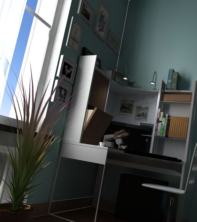

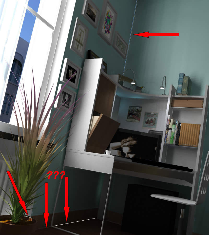

mmmm... I remodelled the walls as you suggested. The problem is still here.
So I link you the whole project zip file. There is no copyrighted stuff in the scene, and it is a non profit work.
If you have spare time to investigate, it would be very kind. If you haven't, it's not a problem. I suppose that the issue is related to the AA pass: before the last pass the shining lines don't appear in the prerender window.

Re: walls
Hi,
you still didn't fix your model. You have holes in the walls.
Also - move your room closer to Origin. The further away from origin your objects are the greater is calculation error. So keep your objects close to origin.

Ok. Now I realized where I messed the scene. The render is clean now.
Many thanks, indeed.

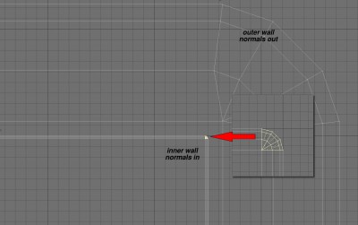

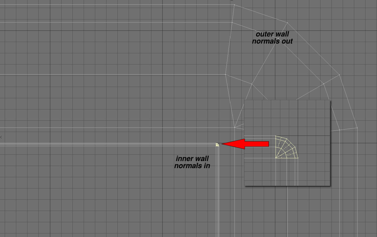

Please, after all that I'm dying to know. How'd you fix the scene?
