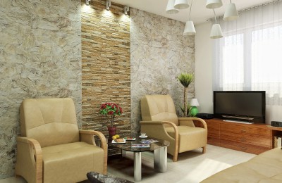

Hi all!
My new render room.
Render time: 3 h (A4 size) on quad 2.4
I used 2 area lights, 3 IES and Physky with sun.
This is clear render from Kray only 20% contranst added.

Can I ask, where did you use the area lights?
I presume that you used physical sky with sun for the light falling through the window, 1 area light extra for the window and 2 area lights inside to brighten up things. Am I correct?

Yes I used 2 area lights on ceiling with power 3
color of lights: brown
the rest is light IES and physky with sun.
on the walls, I used normal mapping,diffuse and reflect texture.
Pass 2 FG 500/1000 blurr 0,5.
FSAA x5 Cathmull
If you using resolution max 1000x I recommend FSAA BOX 0.8 x4 or FSAA x5 0.7
relosution 1600x and up FSAA x5 or x6 Cathmull.
