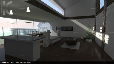

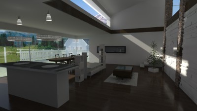

I have some problems getting rid of wall/cealing splotches, ive tried the default settings for interior, made lightportals for the windows and all places where light passes in from the outside. Can someone recomend a good setting? (All models are in scale)
Another thing that bugs me abit is translucensy does'nt match up with lw render.
I have a couple of whitefrosted lights with a iss lightsource. LW seems to have more accurate result in the render (when looking at the translucensy). The lw render have more detail in that area, and it also looks like Kray blurs the photons so that light spreads in to unlit areas of the frostyglass to much. Any tips/tricks on that?
Ive tried the photonmultiplyer on the lightsources but still have the same result.

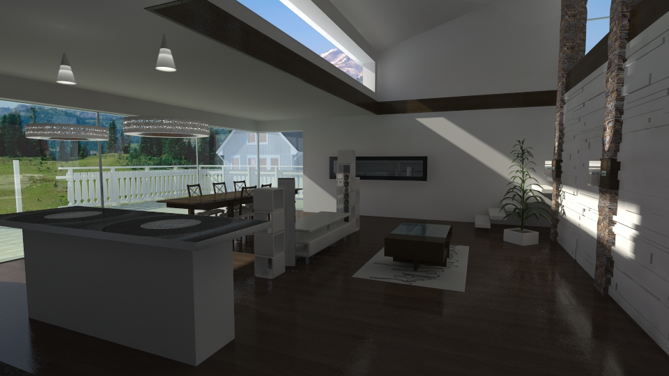

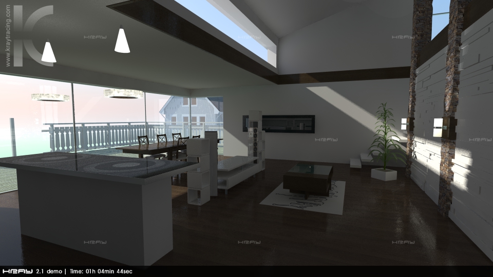

Hi,there..Okej. Here is a couple of renders, one LW and one from Kray. Im using ies lights as spots.
Have a look at the difference in the tranclusency.

Wow you really have made a mess there. Did you know that you don't need all this complicated DPcustom lights? You can just assign luminosity to your lamp material and it will emmit light and be much much faster to setup and also to render...
What you see as a difference in translucency is simply because Kray renders translucency with GI while LW simply ignores it. This makes much better translucency effect in Kray compared to LW... So yes there is a difference but it's the difference to the better.
So what you need to do first is delete all those Dp custom lights. You really don't need them and are only slowing down your scene.
Then check your materials... White wall for example should have color about 230,230,230 and diffuse 100%. Your walls have 65% diffuse right now which means about 30% of light is absorbed and therefore your room will stay dark.
And then I see you have lightportals applied to some surfaces while you are in Lightmap mode. Lightportals will do nothing when in lightmap mode so you can delete them.

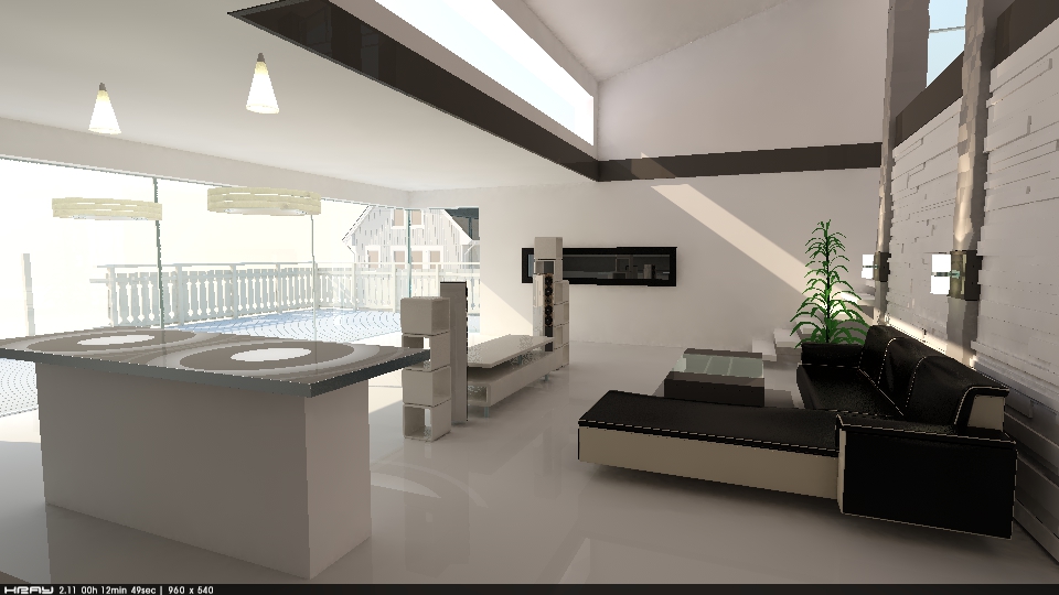

Here's the scene with those little tweaks. I only made fast test render with no AA. You can tweak it from there...

About translucency - I have added a small amount of luminosity to your surface to make them appear they "glow".
