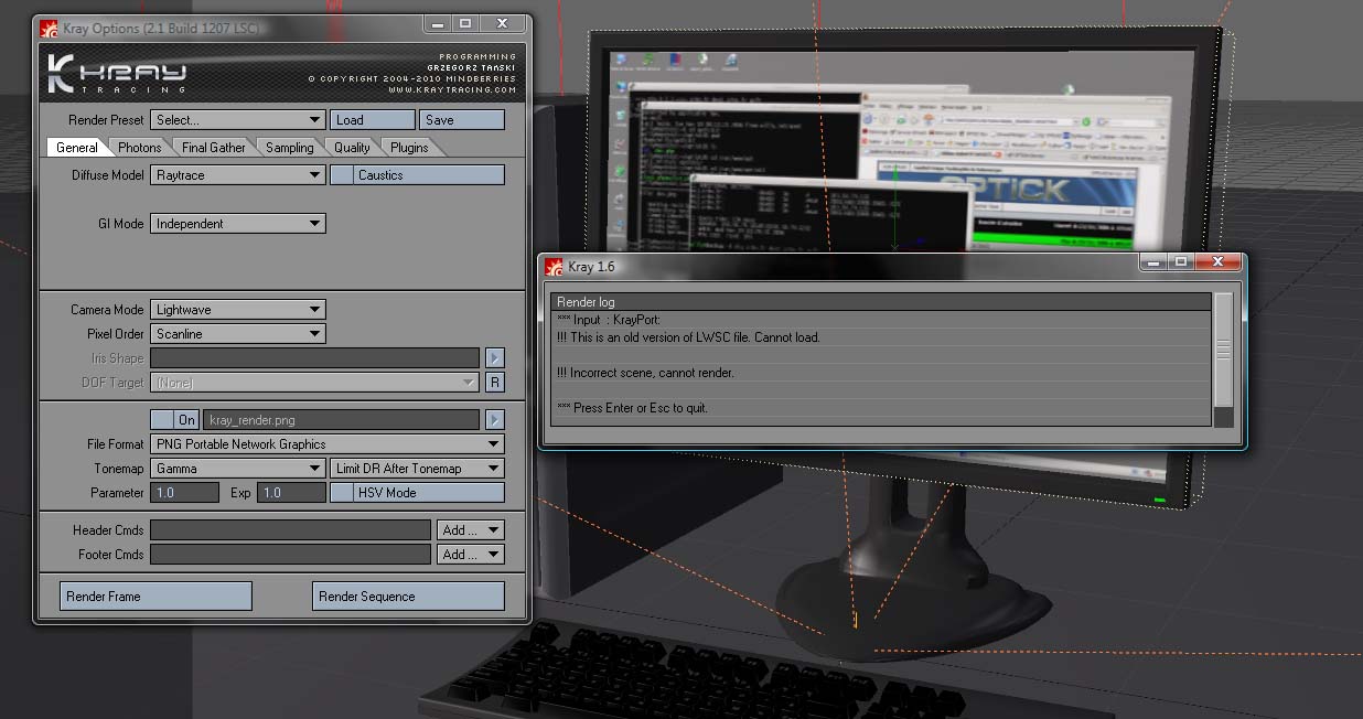

Im having similar problems here with lightwave 9.6 on vista 32
the first errors I got was that when rendering frame it prompts old lwsc file and prompts that its kray 1.6 wich
might be due to 1.6 demo version earlier.
after clearing all plugins and installing again. I at least got it to render an empty scene, then when loading
the classroom sample I get similar errors you had..and then I cant render frame without getting the kray 1.6 prompt error again.

still troubles here...no render..still gives 1.6 kray errors, and checking the edit plugin folder has the scene master lsc script marked with a star, and it prompts that it is located under plugins,lscripts,utilities,master....but theres nothing there.
I tried to add it manually but it prompts that it cant find it..then I just tried to change the extension to ls and that got it loading ..but still same 1,6 kray errors.
Michael
Michael

argh...the kray 1.6 error prompt is back again, that is after working with other non kray scenes and shutting down and restarting
lightwave 9.6 again.
Im almost giving up on this, and sticking with lightwave renderer.
Michael
Michael
Re: installation troubles
Hi,prometheus wrote:argh...the kray 1.6 error prompt is back again, that is after working with other non kray scenes and shutting down and restarting
Michael
obviously you still have old plugins somewhere. I advice you to clean up your configs or uninstall LW completely, delete configs and reinstall it again.
I had the same problem with another plug-in; turned out it was actually in a different folder (one of the endless 9.5 beta installs) which is why I couldn't find it using explorer search, but config still pointed to it. I suggest you turn "autoscan plug-ins" off in Layout general options; then go to "edit plug-ins", switch to "file" mode, find out where the various k-ray ones actually are, delete them from there, exit Layout, exit the Hub, physically delete the plug-ins from the appropriate folder, copy the "right" ones, launch layout and add them, exit again both from Layout and Hub (that should fix your cfg) and you should be set. At this point if everything works you can re-enable autoscan.prometheus wrote:Well clearing all configs didn´t help either, it´s weird thou..it automaticly seems to find a master kray plugin, thou it´s deleted both manually and from edit plugins and even after clearing configs.
