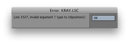

More trouble ahead. LW crashed again, and when I want to open KrayOptions I got this error:
sounds to me you have some corrupted config files. Can you join Kray Skype Public chat and I can try to help you there?
