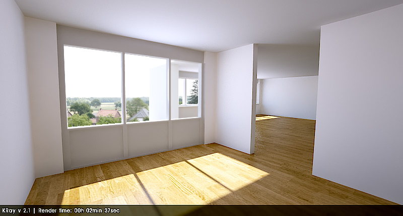

Well...as promised to let you know how it went...
Hereby a render from my own project. Some sharpening and backdrop was added in PS.
The resolution is small though (for testing purposes). Eventually the size will have to be 1280 x 720.
I used area lights in the window (35%, inverse square falloff 5m), physky (without sun) and sun spotlight 250% intensity at 500m distance)
Maybe it is also a bit too blue/purple?
And of course it needs some furniture and stuff...
Thanks!
Thanks!
Re: lighting inteior
I think this look good. better when You use physky sun also. I use also backgroud with excepton of radiation (unssen by radiosity+100% luminosity). Always empty rooms looks ascetic, becouse no furnitures. Please update scene...and use always shift camera (walls looks ugly in interiors when are not vertical...)Maybe desaturate shader is too strong on floor also...I think is good idea experiment with light colours (for example area light in windows stronger blue) good mix of colors (of coarse no candy colors!) make scene less "flat", more "deep"...
