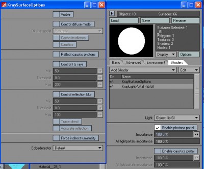

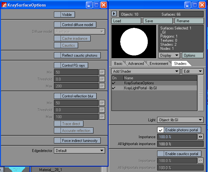

Re: krayphotonnumbermultiplier
This is setup for PORTALS , also You have too use Lumi Ball outside becouse Physky doesn`t support yet Skyportals. if You want use Sun by Portals You have too add second KrayLightPortal and select source of light (Sun). KraySurfaceOptions shader is for HIDE this Portal for raytracing so You don`t need put Portals in another Layer, just unselect VISIBLE (so for Portals You need two shaders: for hide and for setup light):i-media wrote:i have KrayPhotonMultiplier in the "add modifier" tab but not krayphotonnumbermultiplierFor lights: select light press "m" use "Add Modifier". If You don`t have it, please reinstall Kray plugins.
