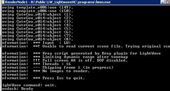

Hi,
I have spend last 2 hours trying to set up rendering of one frame in BNR and KRay, did anyone succeed with newest version of KRay? I am getting this error on all render nodes except the first one (so it looks like it is problem between spiting frame function in BNR and KRay). Only one slice is rendered, the first one. It says 1 frame skipped because I have changed the scene - thinking that it might be KRay not wanting to render frame 0 in lwsn mode - but it was not that.

Re: did you guys tried to render with newest KRay?
Make sure you are using LW output and disable Kray's.soth3d wrote:Hi,
Re: Butterfly / Kray problem when split frame?
thank you, everything worked perfectly fine
