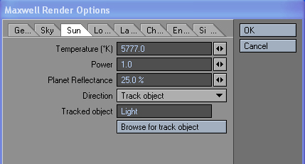

I really like the feature in Maxwell for there Physical sky system. It is very similar to what you have done in Kray just there is a Direction pull down menu. It let you choose track from location (what we have now) and track object. Most of the time in Maxwell I setup sunlight in lightwave as normal then track that light to get same lighting and shadow. It would be great in Kray had this option.

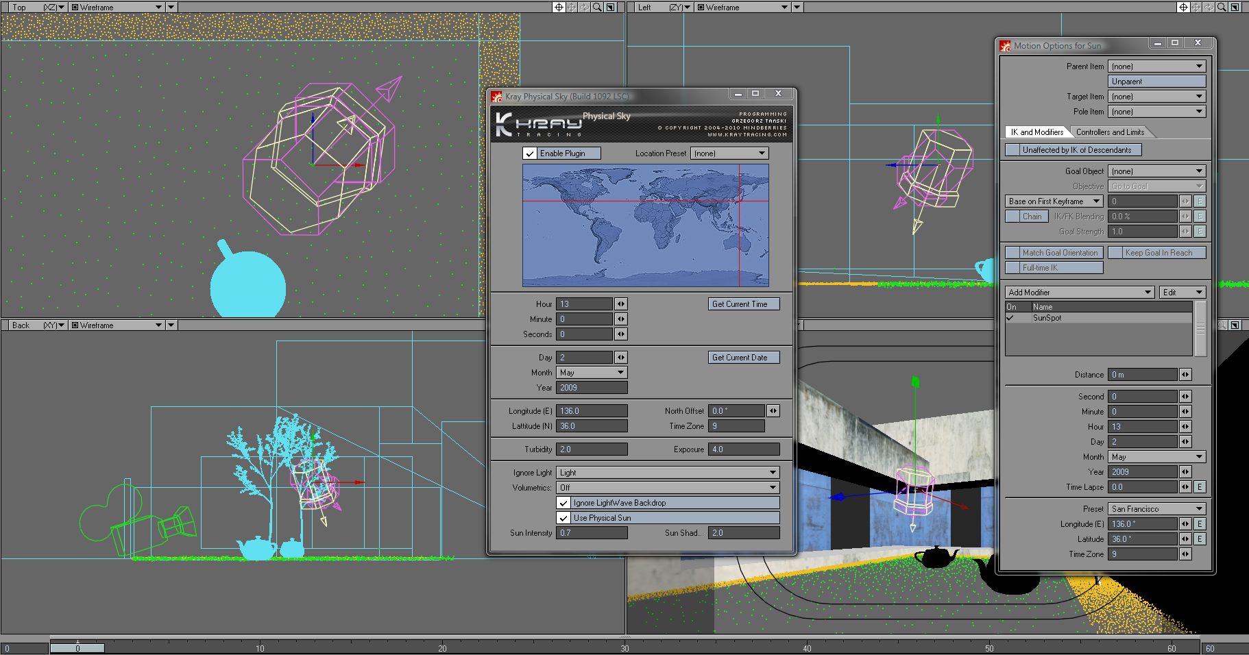

Sorry for droping in like this, but is Krays physical sky north the same as sunspot motion modifier in lightwave, then one can always use that as a reference for where the sun position is. But then I dont know if they match. I guess that Jure can pop in to confirm.
Re: Physical sky setting
salv8or wrote:Sorry for droping in like this, but is Krays physical sky north the same as sunspot motion modifier in lightwave, then one can always use that as a reference for where the sun position is. But then I dont know if they match. I guess that Jure can pop in to confirm.
Yep, Kray physky was developed so that it matches LW Sunspot exactly.

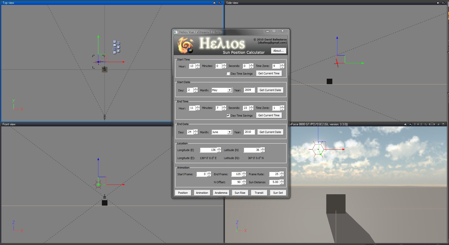

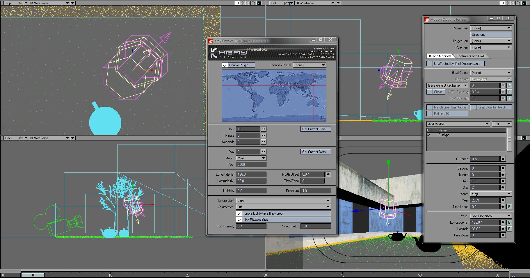

Hi,
I told Jure on Skype I was trying to match the Sun on a xStream Scene with the Simple Exterior scene. Becuase xStream doesn't have a Sun Spot modifier i wrote my own Python Script to do it. It doesn't match Lightwave Sun Spot Modifier (and maybe it's due to a difference on the calculations).
My surprise came when I tried the Kray Physical Sky and the Sun Spot Modifier on the Simple Exterior scene and the don't match. Look to the attached screens.
