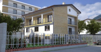

Nice render salvatore. Like this very much.
For comment only 2 points for me.
1.- Grass is so much saturate, i like more desaturate and little dark green.
2.- Border of roof is rare material.

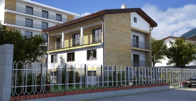

Re: new exterior
looks good!
please increse contrast, under roof must be dark in corners and more colours .
Re: new exterior
thanks for your advice.
In this render:
1- improved contrast
2- more colour
3- desaturate grass
4- texture under roof
 In this render:
2- more colour
3- desaturate grass

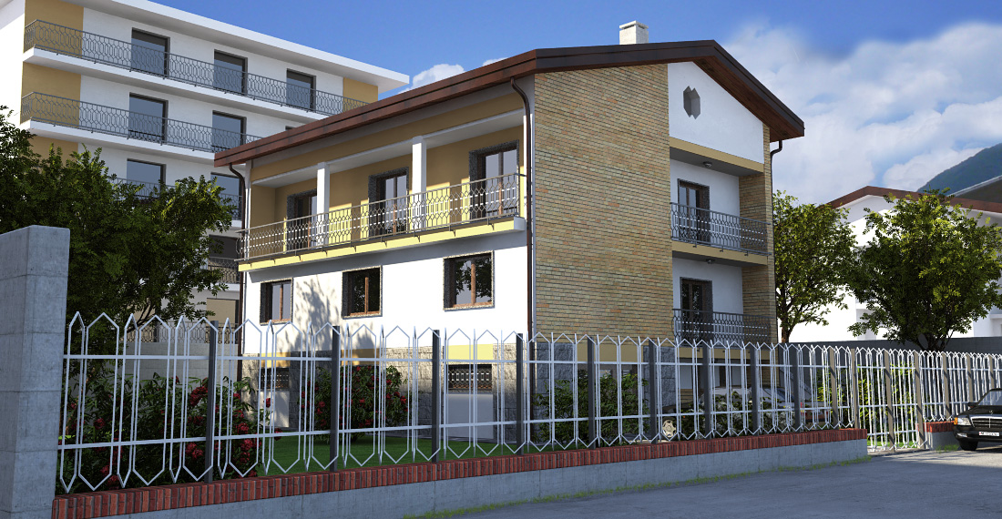

Re: new exterior
I thing Your enviroment is too bright
Put please: more trees or down brightnes sky + better GI (i see contact shadow under roof and splotches)
Please use Power for Sun (maximum 4)
Re: new exterior
yes. true.
The enviroment is too bright
in this render the sun has 6 power
I followed your advice
thanks
thanks

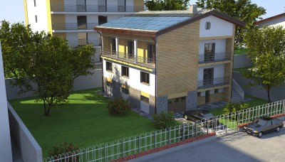

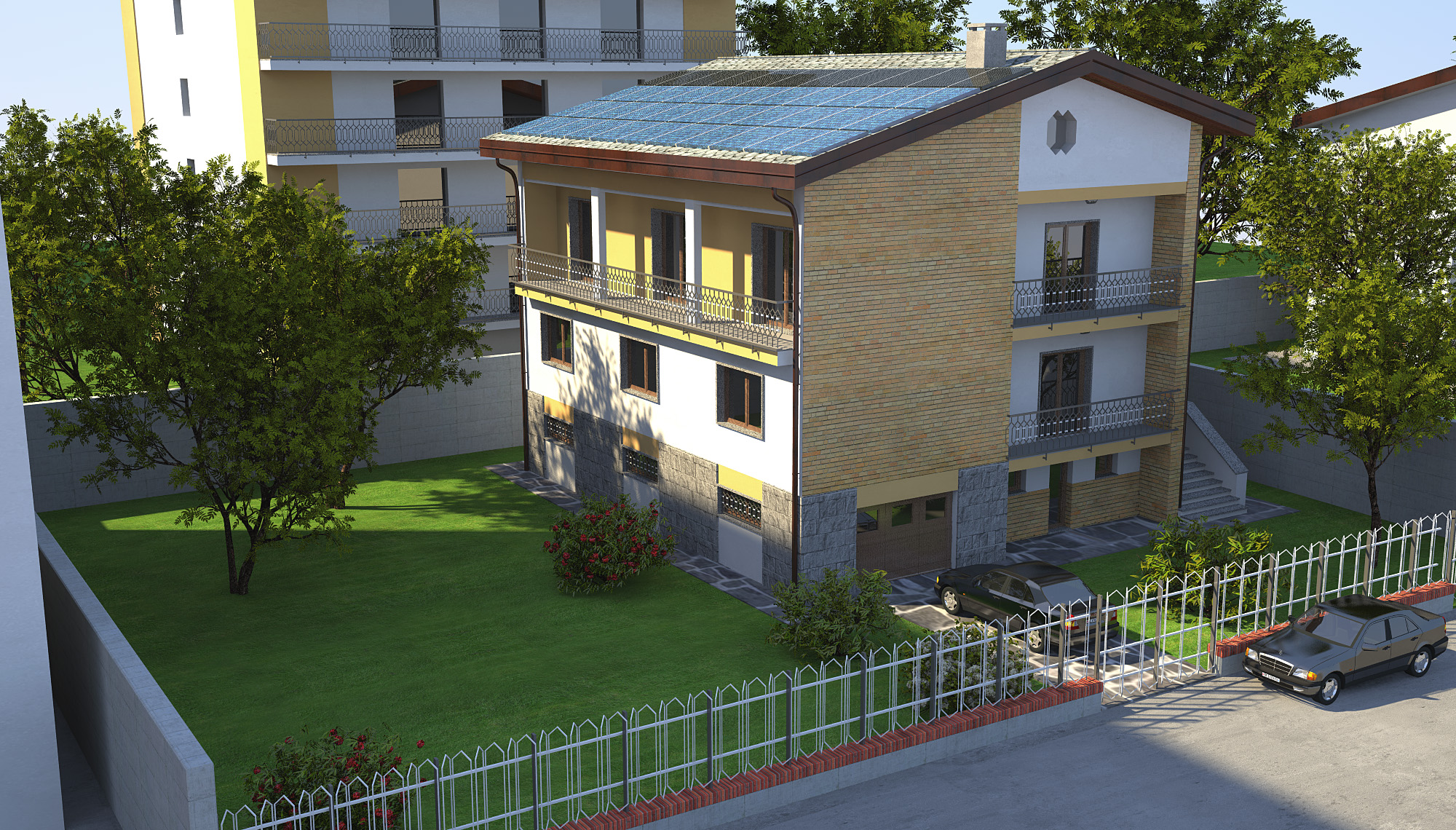

Re: new exterior
i follower your advice.
A new point of view
less power sun and sky
more colour and contrast
a little PS post
						A new point of view
a little PS post
Re: new exterior
I like more the first view. But if you need this shot , need to work on garden.
Try to do a mesh for grass with some jitter deformation to make more natural level. And try to add some grass with kray instance to improve the bored grass.
Too need to work on the texture, is deformed and i can see the tiled.
Why solar panels have diferent textureS? First line ok , but not others.
Ilumination better now
Re: new exterior
ies i see
i need work to texture but i have no budget for this work
first is solar panel, other fotovoltaic and this is customer shot
good idea for jitter gras! i will test.
thanks. For me is very important you advice
