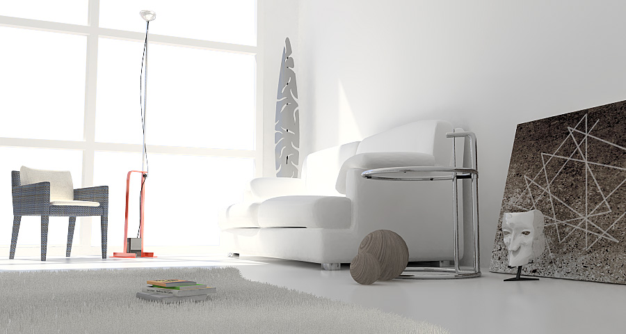

exponenzial 2.2 power 0.5
sun 160% 1.1Km dist 2 Kray PhotonMultiplier 500/8 - sunspot plug-in
sunsky plug-in Brightness 200% saturation 90% gamma 2.0 - turbidity 4.0
ceiling with shader Kray PhotonMultiplier diffuse number 2.0 power 2.0
carpet with kray istance and shader KraySurfaceOption FG 100min /300max
All advice are welcome

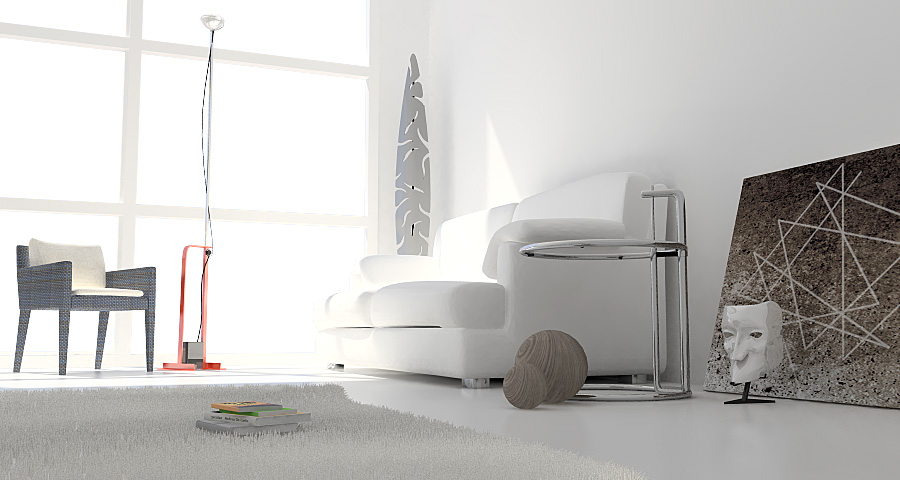

Re: interio
nice light!
fix texutre on chair, add some image outside, add krayindirectrays shader to carpet and turn multiply to 0-0.5 to make more dark shadow in carpet.
						Re: interio
thanks
i follow your advice for the carpet and the burned
next render will be better

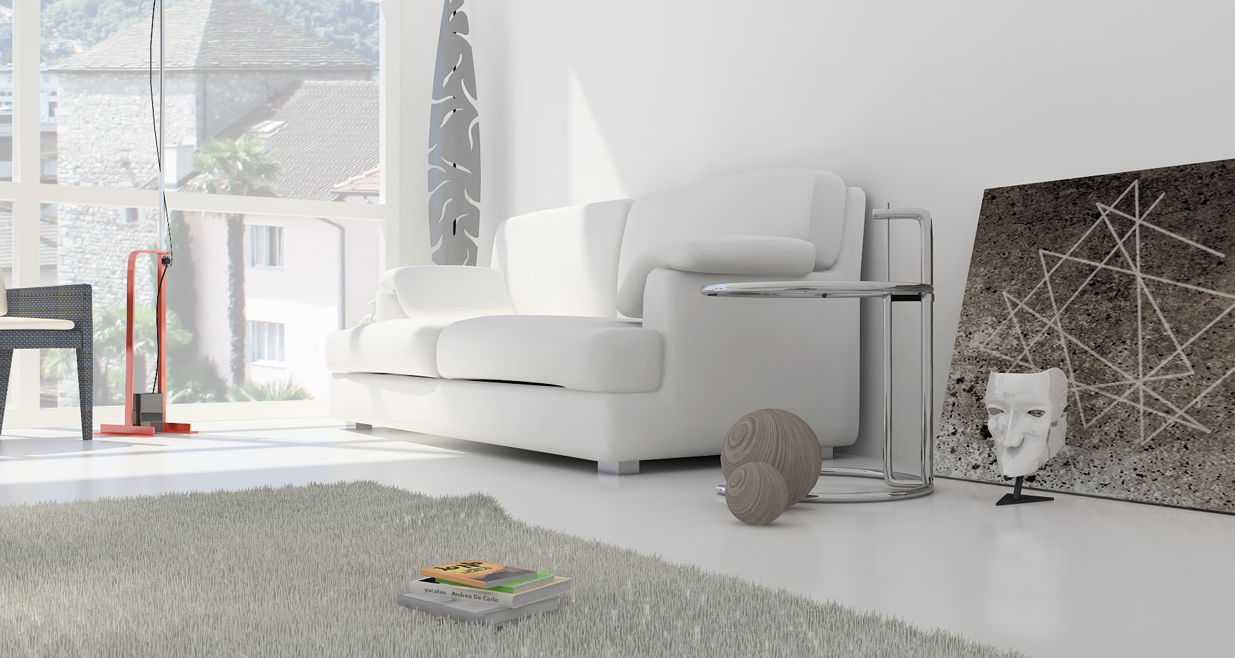

Re: interio

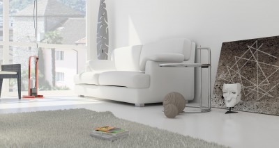

For me so much better now armchair no burned.
For carpet try to bend some fibers and add few more to original instanced object
Great ilumination
Great ilumination
