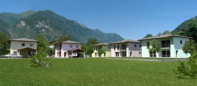

exterior
Re: exterior

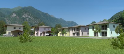

with grass small
is better?
how render a better grass with short time render?
						is better?
Re: exterior
You can`t increse speed render (becouse this is complex obiect) ... But You can use QMC shader 50/0.
  I know: nature is very hard to copy...
  I know: nature is very hard to copy...Re: exterior
Nice ambient. Like your ilumination.
I think you can improve so much your image, is poor in details. But nice composition.
Your trying to simulate grass or wild ground? try to add some rocks or wood, and displace the tree on center of image.
Try too to add some more details to break the big and simetric grass, add too some jitter to ground to make more realism
Re: exterior
I like the buildings, but for me, the background is too blurry, and the 2d trees don't look very good. The grass just looks wrong. I have a problem with this kind of grass - it is far too even and regular. In reality, most short grass is patchy. There are occasional flowers, weeds and stones. If the grass was this long, then it is neglected, and neglected grass always has weeds
The best thing about this for me by far is the houses.
I know a lot of people are using the instanced grass, but even in the best images it is only just convincing. I think you would have been better off with a good texture map.

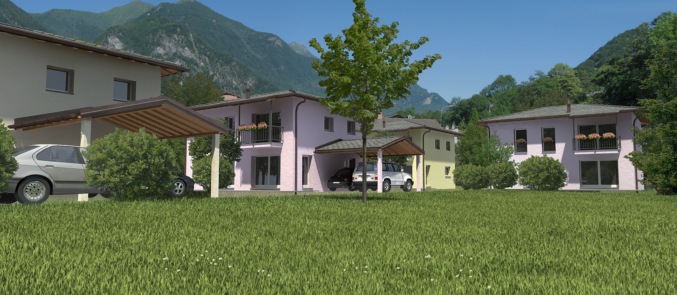

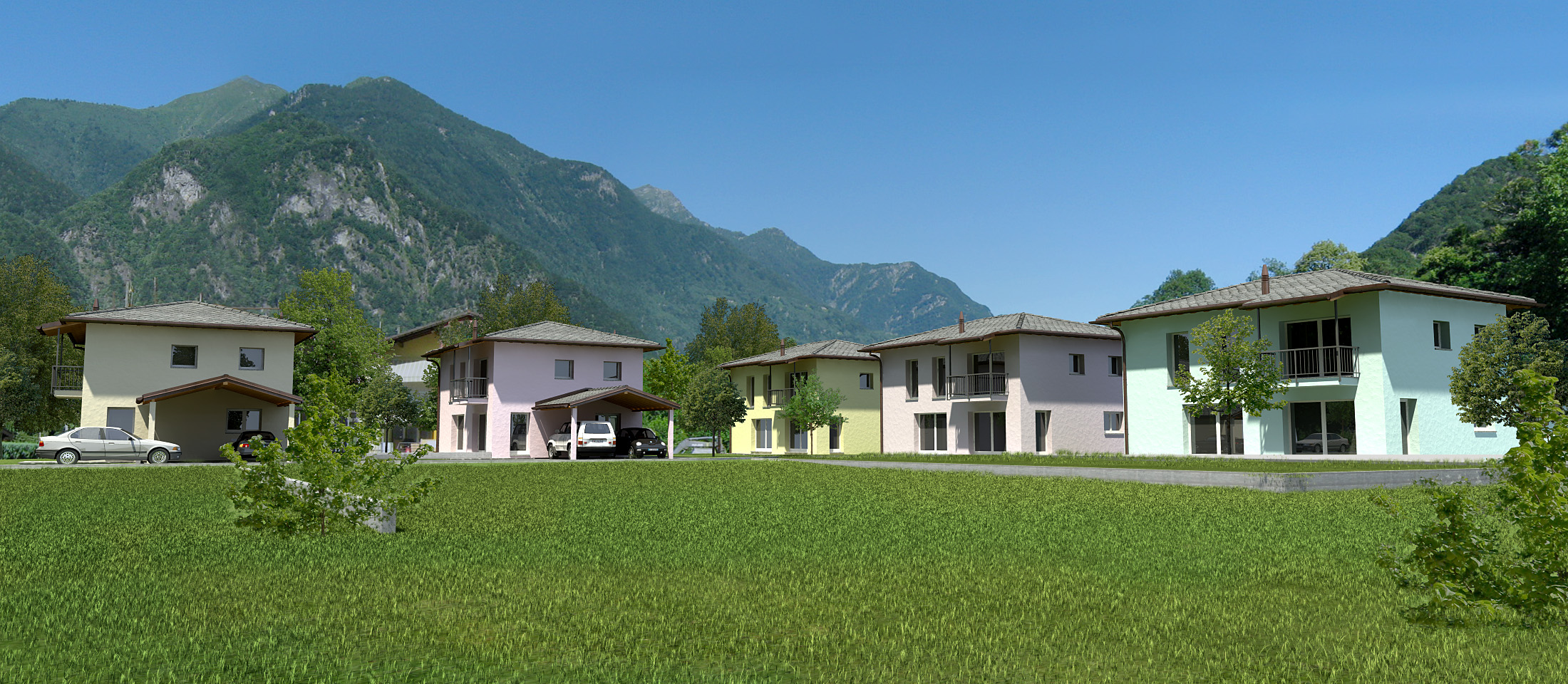

Re: exterior
a new step to the improvement of grass
render 2200x960 px
Kray exterior preset
12 h render time! (quad core 12gb ram win64 )
it still looks fake
						render 2200x960 px
it still looks fake
