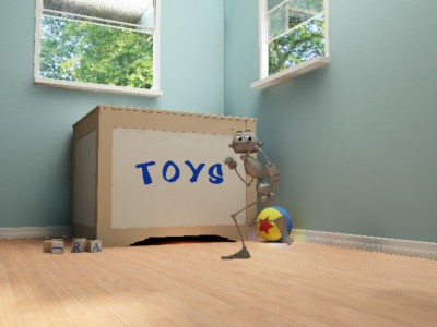

Hey everyone, I've got an animation project that takes place in a childrens room, so...I'm using Kray. I'm taking an animation from Maya exported through Point Oven (bakes the points/vertices/ect. of the mesh producing a .mdd file for each object) in to LightWave. I notice though that Kray doesn't render the shadows when using "Shared for all frames" and "Allow animation" checked. It works with no GI cache.
My 2nd question would be why am I getting light like that underneath that ball? It's not luminous.
Re: No shadows on animation
1st Q: that is correct. Shared GI will only render static indirect shadows. However if you add area light for direct shadows then you will get animated shadows...
2nd Q: it looks like light leak. Check your photon map if it is maybe blurred too much (bluring photons from outside with those from inside)

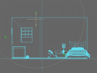

I've got an area light ceiling height shown in the attachment. I'm confused.jure wrote:1st Q: that is correct. Shared GI will only render static indirect shadows. However if you add area light for direct shadows then you will get animated shadows...
To weak...I had it upside down (-90). I'm a knucklehead...jure wrote:Maybe it's set to render as indirect? Or it is too weak?
 I'll post later the re-rendered results.
 I'll post later the re-rendered results.Larry V
