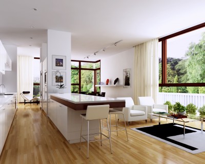

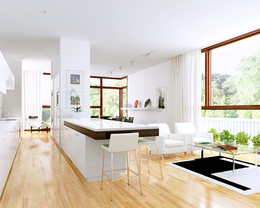

Interior evermotion free scene
This is scene from http://www.evermotion.org/?unfold_exclu ... =exclusive
Time render 45 min. Area light in windows (same setup V-ray ) +Sunsky.
I will fix some part later (bad AA, light leaks, etc.)

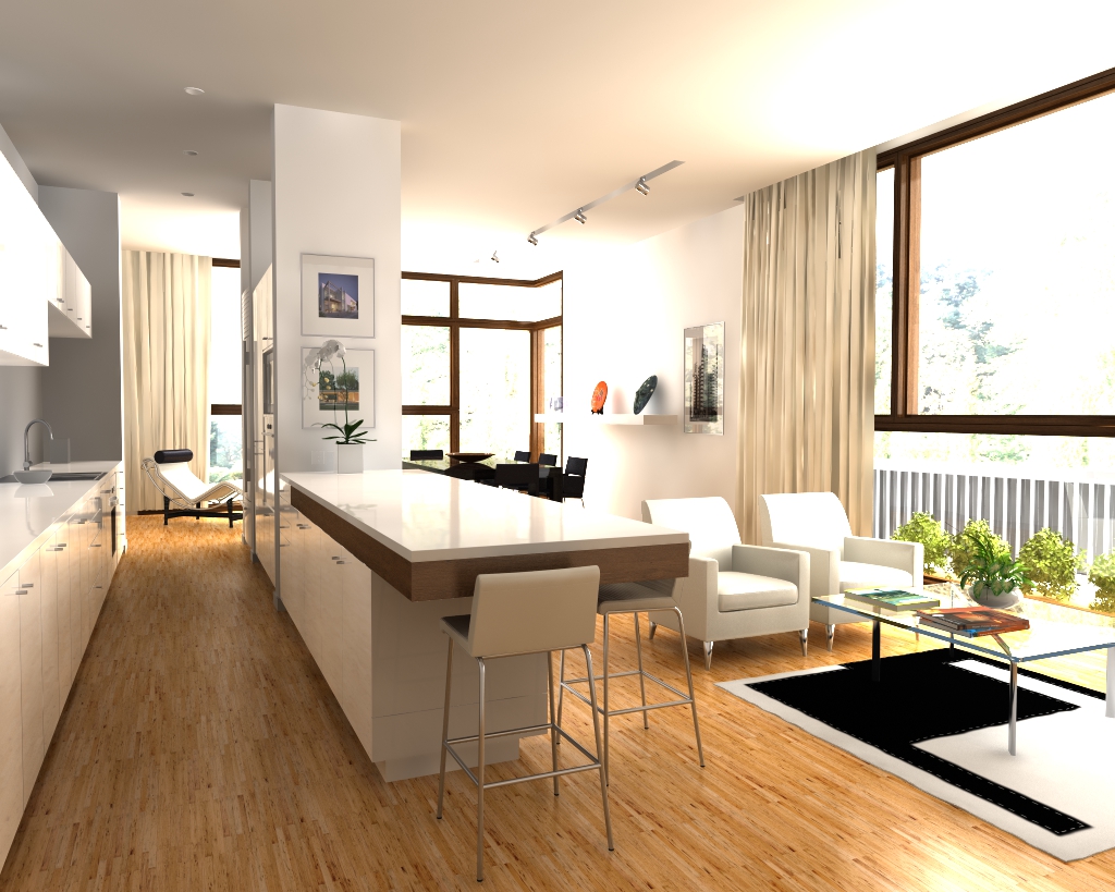

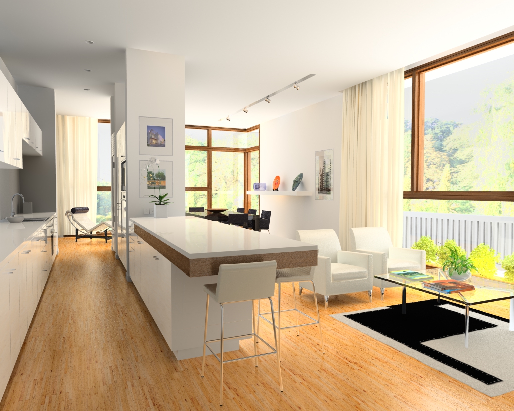

Thank for the scene Johnny.....I hope you don't mind if I post my attempt here :) .....time 29m 13 s on a dual quad xeon 2.66 4 Gb ram...no area lights on the windows...just Sunsky+Sunspot and the GI sphere without texture.....2 prerender pass , 3AA fullscreen with High settings....it's completely different from yours and the Vray one but I like it...:)....hope you like it too.... :)
Re: Interior evermotion free scene
vsele wrote:Thank for the scene Johnny.....I hope you don't mind if I post my attempt here :) .....time 29m 13 s on a dual quad xeon 2.66 4 Gb ram...no area lights on the windows...just Sunsky+Sunspot and the GI sphere without texture.....2 prerender pass , 3AA fullscreen with High settings....it's completely different from yours and the Vray one but I like it...:)....hope you like it too.... :)
Complety difference becouse You used basic setup :lol:
Please use Sunsky (text. Envir.) only for reflections but You need some light from this . Put Area in window http://www.evermotion.org/?unfold_exclu ... =exclusive and add for this Power Shader 3-6. I don`t use prerenders pass. You can put on the floor surface Shader: DiffusePowerMultiplier - 1.5 or 2 (higher value transport too much photons) in KrayPhotonMultiplier (if You recive light leak put in DiffuseNumberMultiplier value ~20.000 - 100.000 for correct errors) Of coarse this floor are bright, but dark floores too much "kill" photons from outside and Power shader from sun can`t help. This is nice trick to increse brightnes inside dark rooms.

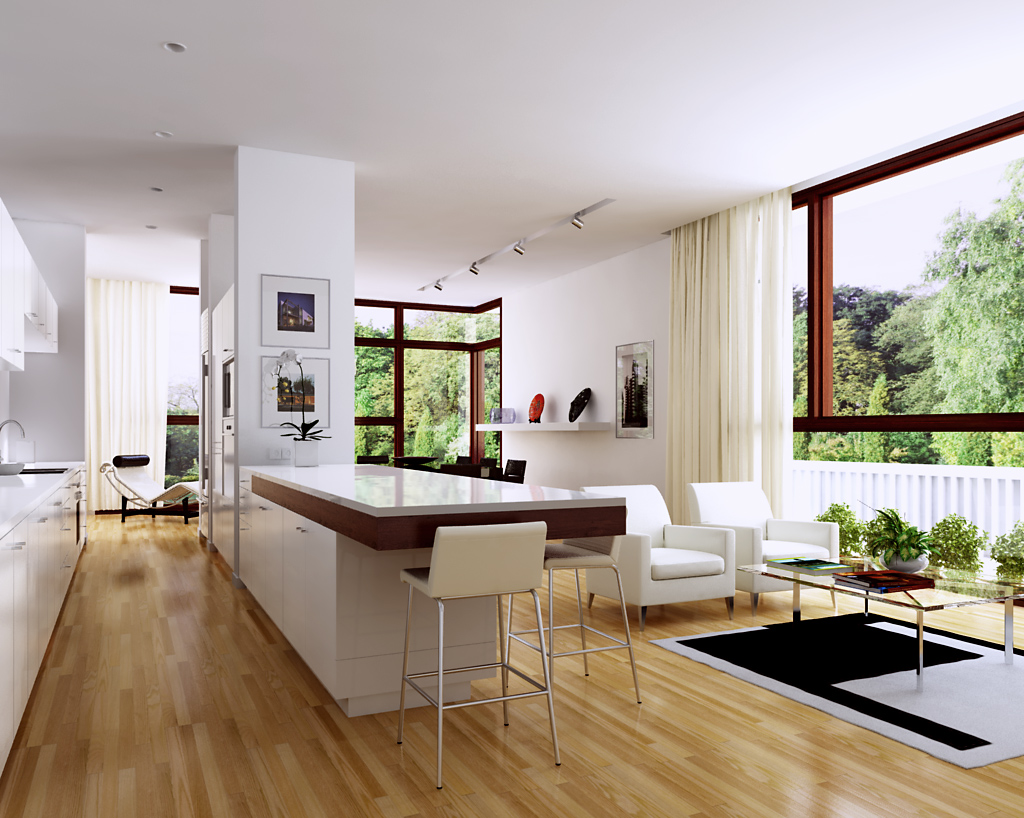

LW rew
I like your render but I think the colors are burned out too much on the right... If you can fix that it will look great.

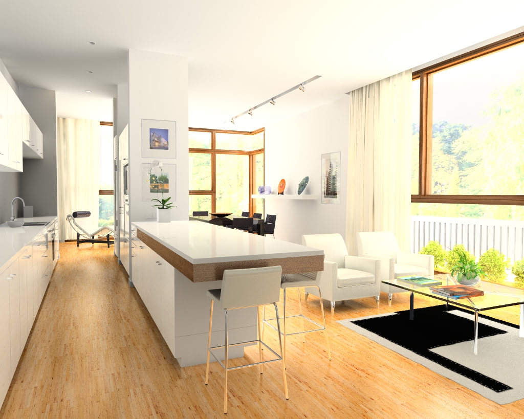

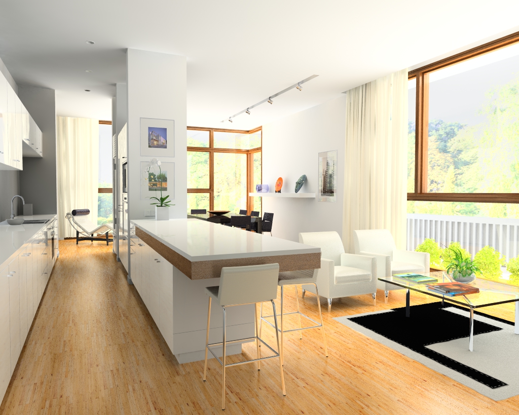

Ok I've changed the exposure of my first render and you'll find the result on the first render:time 1h 39m with 2 prerender pass spatial tolerance0.03(i want contact shadows under the glass table) and 3AA fullscreen with High preset...the second render is with area lights on the windows..time 54m but with less photons fired and Spatial tolerance 0.08 (no contact shadows under the table..) the third one comes out from LW internal render: time 2h 18m FG 180% with 6 pass of classic AA..it's a bit burned but it's not that bad....MinPixSpa 2 MaxPixSpa 20....10 indirect bounces 400 RPE 12 SBR AT 35.......
PS : Thanks Jure.....:)
Kray with modified exposure
Kray Area
Kray Area
LW render
LW render
Nice tests,
I think you need to reduce the yellow tint in your renders. Maybe your sun is too yellow?
The LW render doesn't look bad at all if it was correctly exposed - it does lack detail shadows though...

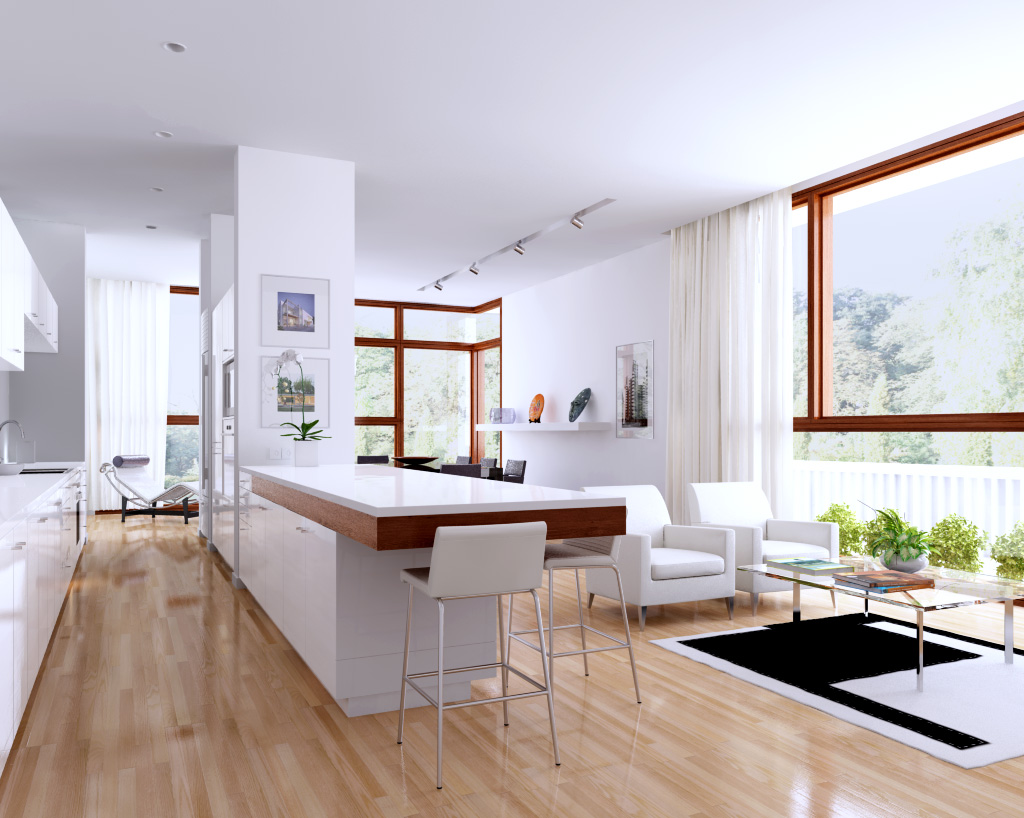

My next update.55 min (I know: this is long time render , but all surfaces have blurr and reflections) Small PS after.
btw: this is small experiment with LWF: LWF plugin + exponential in Kray.

I love the colors in this render! Perfect work!
