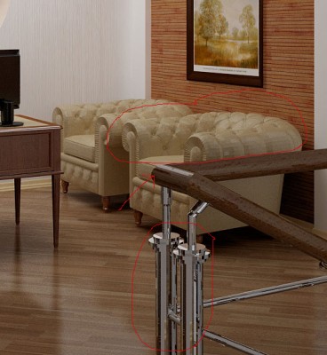

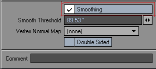

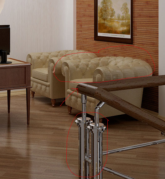

LW 9.5, Kray OB8. Smoothing error

Help to correct mistake!
