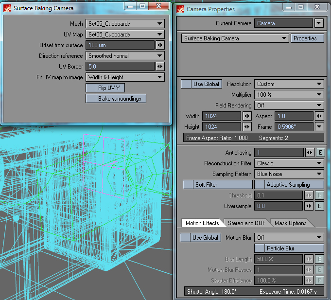

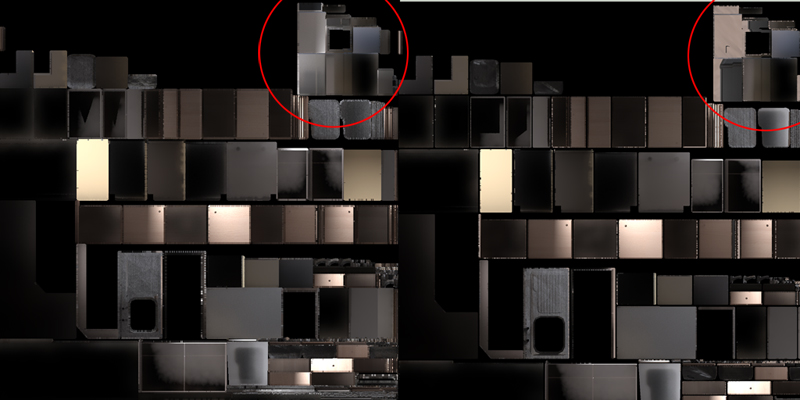

Re: Surface Baking Camera Broken, Incorrect rendering

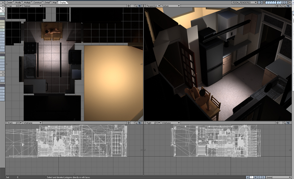

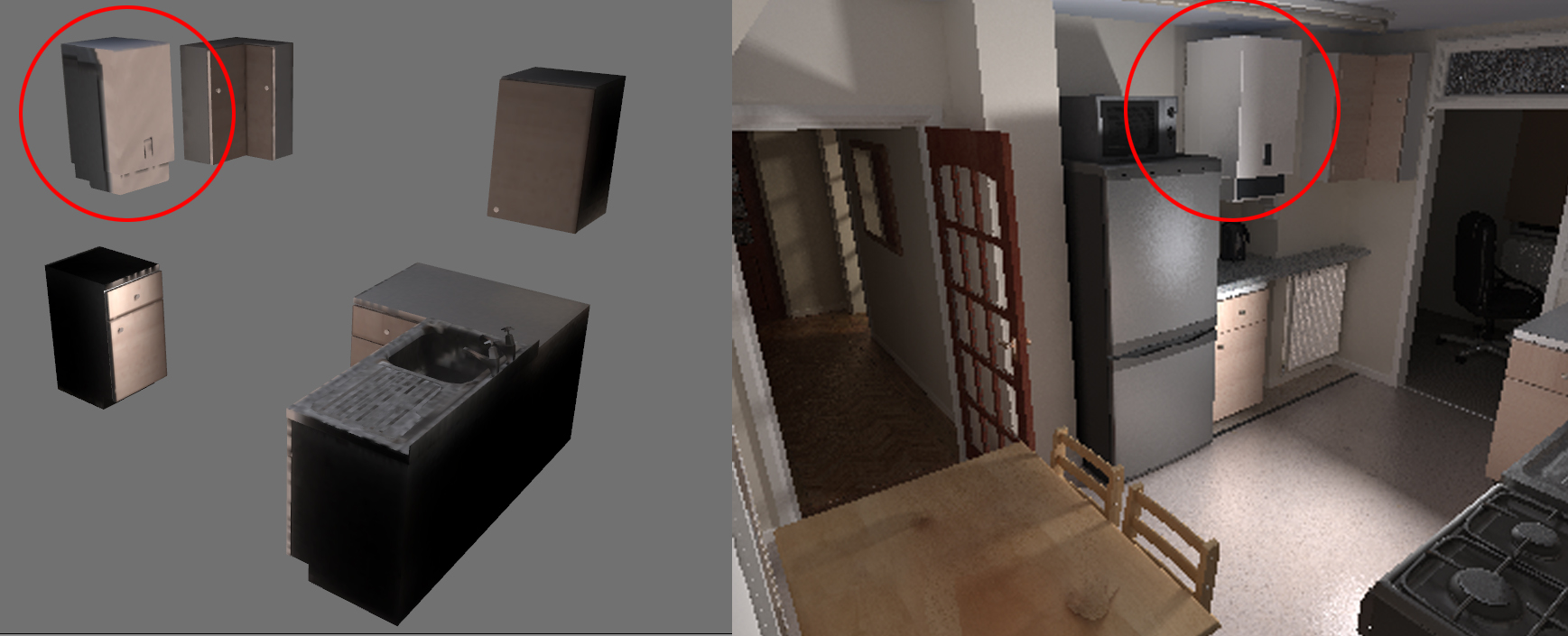

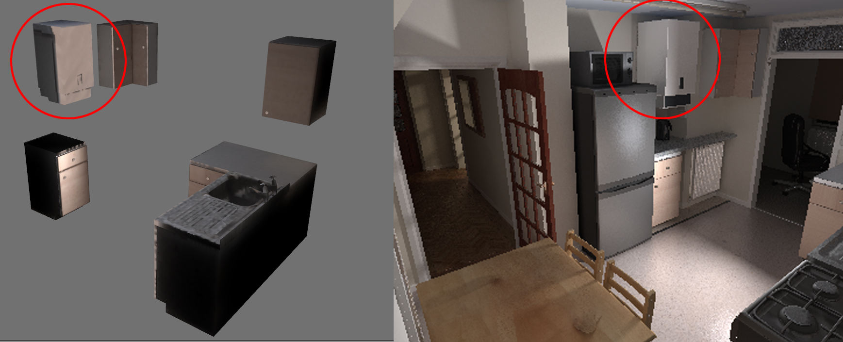

Ok guys, attached are some exmaple renders and screenshots.
I broke the scene into pieces to be rendered out seperately and ATLAS UV mapped to have the Baked renders applied. Each part was triangulated and the UV mapping tweaked. Then each part rendered one by one loaded into Modeller, cloaned and given a new material with the baked texture on it.
Some of the sections rendered out ok when baked but some had inconsistencies, some where darker and some just had scewed rendering.
I am using an older version of Kray I think and Lightwave 9.3, 64 Bit Vista.
Am I doing something wrong?
As you can see in Diag 2.jpg. All I did from the good version left was up the res and quality then the render screwed up the bake on the right. This is just one example of the battle to get these Baked textures out from one scene part by part. To reproduce the whole rendered scene in 3D.
Dia 03 .jpg shows the whole scene in Modeller mapped, some textures where darker than the should be due to Krays inconsistencies. Now the new version I am working on just doesnt work at all! ALl I have is one light in the scene. 24 bounces etc. As you can the render in Diag01 on the right works perfect but when baked out just screws up! left
Any help or ideas would be much appreciated.
Hi,
Not sure I've seen this problem before, then again I haven't done any baking in a while.

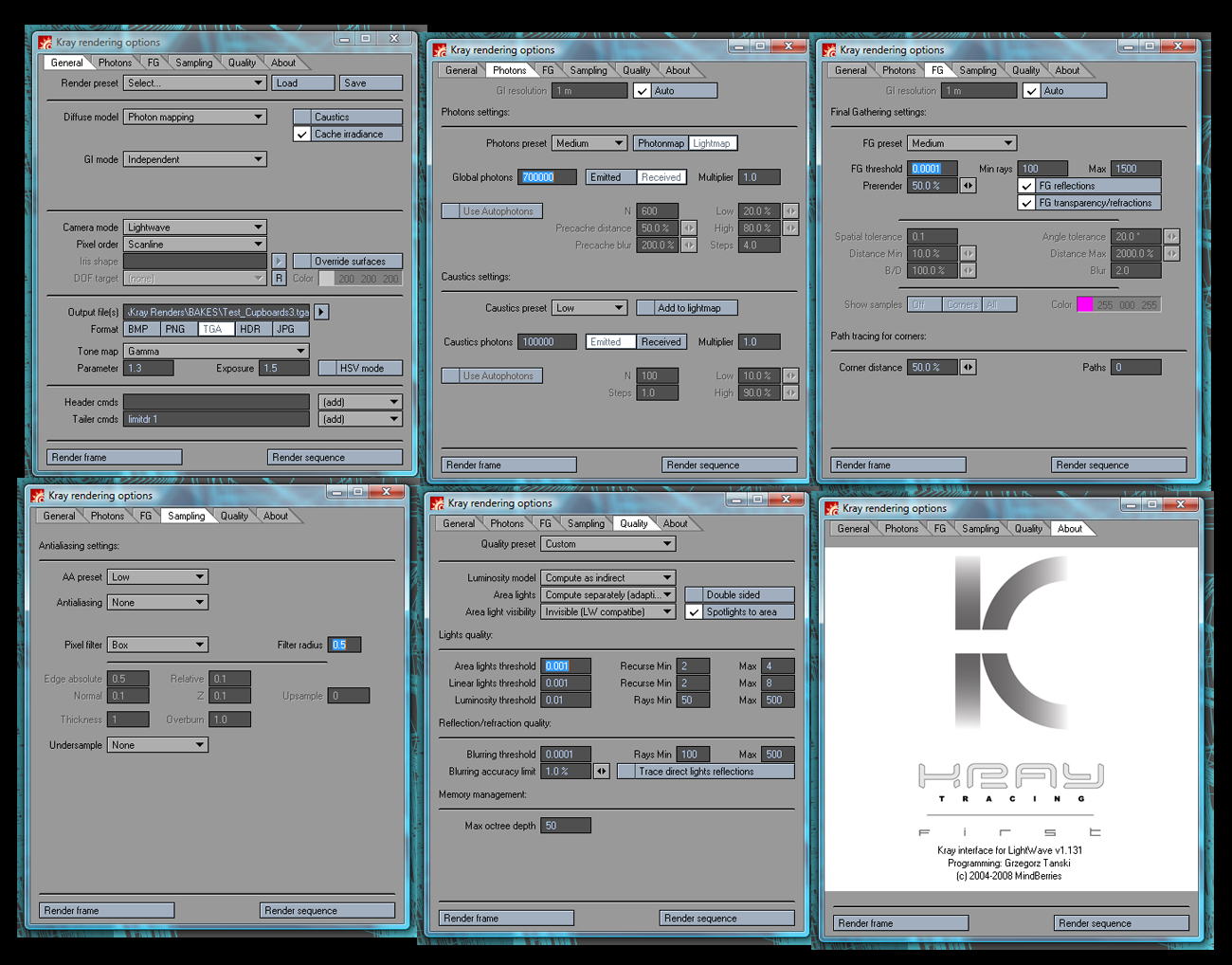

Could you try Kray's own baking camera (in the "Kray rending options", under "camera mode") and see if you get the same results?
During rendering if you look at the top of the render window you will see which version your using.8Infinite8 wrote:Also how do I find out which version of Kray I am Running?

Thanks Haven 1000, I will try that. I might be back again to rant some more!! I love Kray's renderer. It's just so frustrating what I see in the render should be transferable to the baking process, it really doesnt even matter if relcections and speular are baked, just so I can get that whole moment frozen in time from that one angle.
						- 8infinite8
- Posts: 29
- Joined: Wed Jun 04, 2008 9:15 pm
Haven! You are a legend! thanks for pointing that out I didnt realise there was a Kray Texture Baker in built. That's ace, it has got rid of all those rendering errors I was getting with LW Surface Baker.

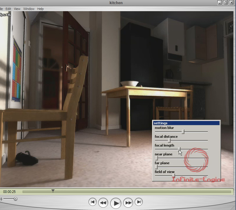

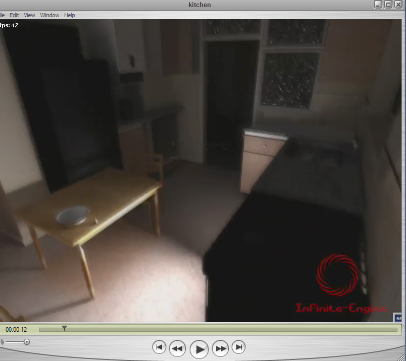

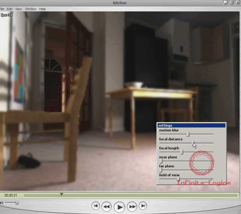

Haven1000 you are a life saver and you have pointed me onto the road of freedom! Kray is amazing! The best renderer on the market!
See attached movie file of the scene
Realtime Kitchen http://www.infinite-realities.net/downl ... est_01.mov
I cant wait to render out some more detailed textures, these were all rushed and rendered in about 30 mins a piece on low settings with very bodged Atlas UV's. The possibilities here are endless. Viewed in my realtime OpenGL Viewer. Infinite-Engine featuring realtime DOF and Motion Blur. Currently the viewer is WIP.
Recognise the scene?
Cheers
Lee
 Cheers
Lee
WOW! excellent stuff Infinite,
You've got to give us some more information on your realtime engine.
What..where...when...why? come on spill the beans
BTW krays baking has always been one of its biggest secrets, I'm glad you like it.

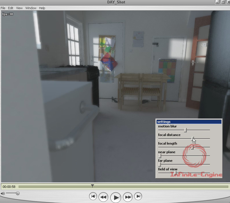

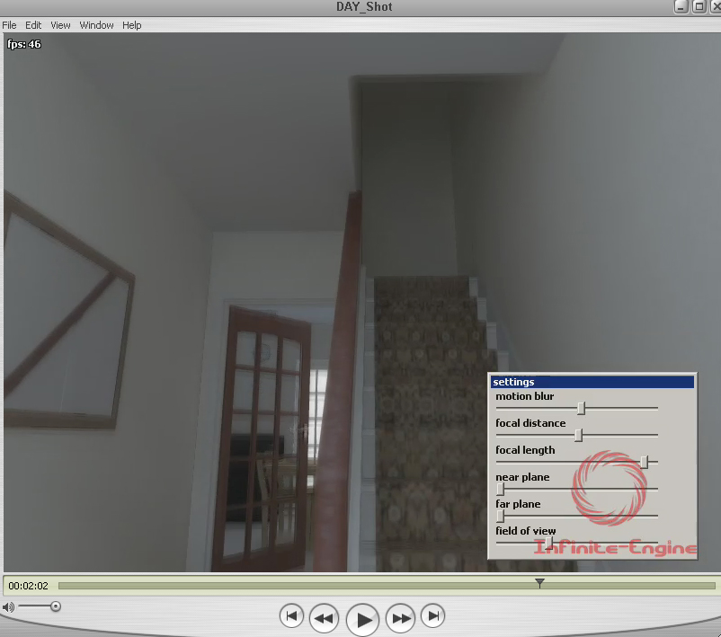

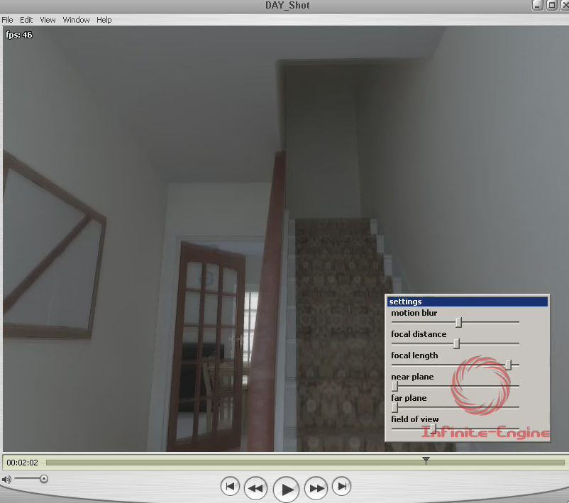

Added another movie here.
http://www.infinite-realities.net/downl ... Y_Shot.mov
Added a new version lit in the day time
Again very rough, some bad areas like the radiators which I will change. But not bad for a 1st pass, it's a shame everything is baked in like, refraction and reflection etc
More to come.
PS would it be possible for a MOD to change this thread and put into the Gallery section? as the title is wrong now
Instead of Surface Baking Camera Broken, it should read Kray Hidden Feature, Surface Baker unlocked!
