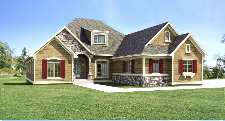

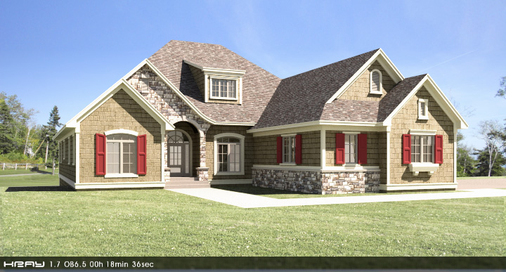

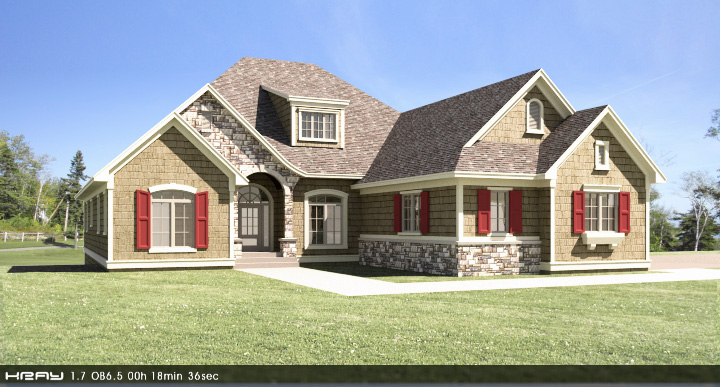

Had a few hours today to kill, so thought I would give it a try. Fprime version and Kray. needs alot of work but just simple scene to test shading, no landscape.

Hi, good job!vpii wrote:Had a few hours today to kill, so thought I would give it a try. Fprime version and Kray. needs alot of work but just simple scene to test shading, no landscape.
what is your technic with the grass? It is so real...
I'm sure some of the experts in Kray could get it faster too, but I really think exteriors wise (not over Kray) FPrime still shines. For speed and quality, it's a great bang for your buck. I know guys like Johny & Pheidian have been working hard on master exteriors on Kray, so it'll be interesting to see what eventually comes from that.vpii wrote:Fprime seemed faster, I stopped the render around 8 min. I am sure expert Kray users could render faster. I was just using high preset.
i still stick to frime for stills. I can not get colors ever right in Kray. I use G2 plugin heavy so Kray makes it hard for me sometimes. I did use Kray for a good sized animation of an exterior and the instance of trees and shurbs worked great. What I am disipointed in is the lack of support for moving items, cars etc. They say maybe soon.

why are you using the way old 6.5 OB? Trouble is the presets need an update, high settings use too heavy AA and most of the settings in there are ok for interiors but overkill for exteriorwork.
Switch from photonmapping to pathtracing. Use uncached with linear tonemapping and enter the same multiplier in second tab as you put in fprime master ( so 180% would be 1.8 ) to get equal results, (apart from the tweaks in G2). Use indirect lights in quality tab and keep bounces 1-4.
Enter a max FG value of 800 to start with.
cheers
ric
btw find the save passes option in kray indispensable, kray just has some stability issues and quirks (instances made it crash today and made me very unhappy) so sometimes i end up using trusty frprime to save the day
