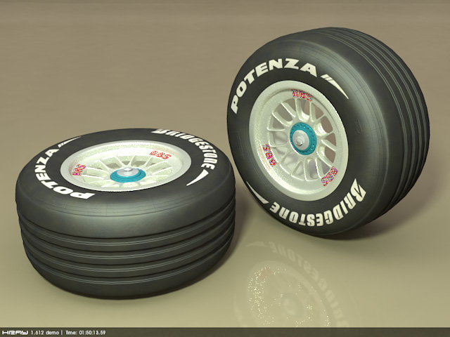

Just as I thought I'm getting the hang of Kray, things go wrong. This is a model I built along with the steering wheel I posted earlier as part of an entire F1 car I am modelling. More posts and render to follow on the car later! I can hardly wait!
Anycase, I am getting a lot of white spots on the renders, and the blurred reflections are very grainy.
I have used an HDRI image, uffizi_probe.hdr for GI lighting and reflections.
Wheel 2000fg_resize.jpg (57.36 KiB) Viewed 12551 times
GI Settings.zip
GI settings used to render.
(299 Bytes) Downloaded 660 times
The cool strawberry man!!!
Posts: 453
Post by silverlw »
The higher dynamic or strenght you have in a hdri, the higher settings you need in ANY renderer to get a splotchfree/noisefree render. One way to solve it is to limit the dynamic range of the hdri a little bit by adding "hdri exsposure" to the image, example whitepoint 1.0 /blackpoint 80%. There is plenty of tutorials about this subject all over the net. Another way is to increase precision in the renderer,higher settings for blurred reflection, more FG etc.

I've tried a few things now, from removing the HDR image, to removing reflections, but that's stupid, reflections are a must.
I have now crancked up the reflection blur max to 1000. Hope that's a reasonable value.
Render will hopefully be ready in about 1h30. Coffee?

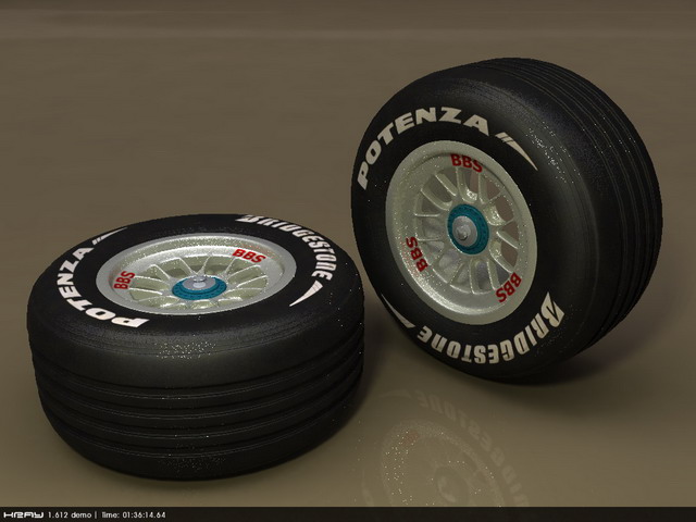

Having no problem with dots on the brown stage, but the rims are proving a bit tricky. I suppose I'd have to ramp up the settings even more.
Note the dots on the rims. Working on it.

Okay, no matter what I do, this stupid image won't render right. I'm getting fed up and Kray is on its way out the front door.
I've upped the photons to 500000, the fg rays to over 2000. I've tweaked the freaking blurring settings, and tried adjusting the HDRI.
I'm out of options and unimpressed with Kray.

I've done test renders with 1%, and 100%, both produce noise. I tried raising the min and max to 1000 each, which reduced the noise. Then I raised both to 10000, which finally cleared the noise, but it took forever to render.
