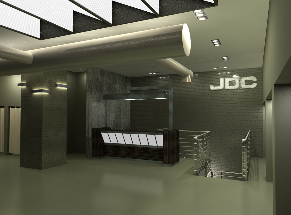

The first image "test.jpg" is render with some material problem, than I've used to see the global light result and correct the error.

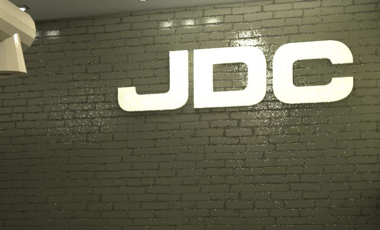

The main problem was the noise of reflected light near JDC logo that is visible in "test-part.jpg"
This is my kray settings
Photons preset - medium (photonmap, emitted, multipler 4.0)
FG preset -low
Sampling - medium grid 3
Quality preset - medium but with luminosity threshold 0,01 - min100, max1500 (reflec/refract min100, max1000)
Image resolution 2048x1536
Time render about 13h
In the scene there are 50 poly light (part with autopart plugin) and 7 lw light.

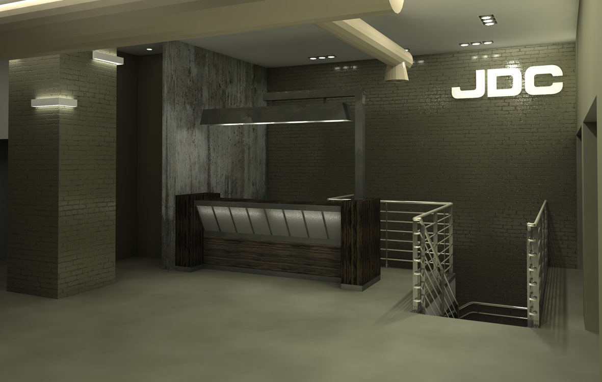

I've tried to activate the "trace direct lights reflections" (to try to resolve the noise of reflected light) and the result is the image "def.jpg" .... but about 28h at 2048x1536 resolution.

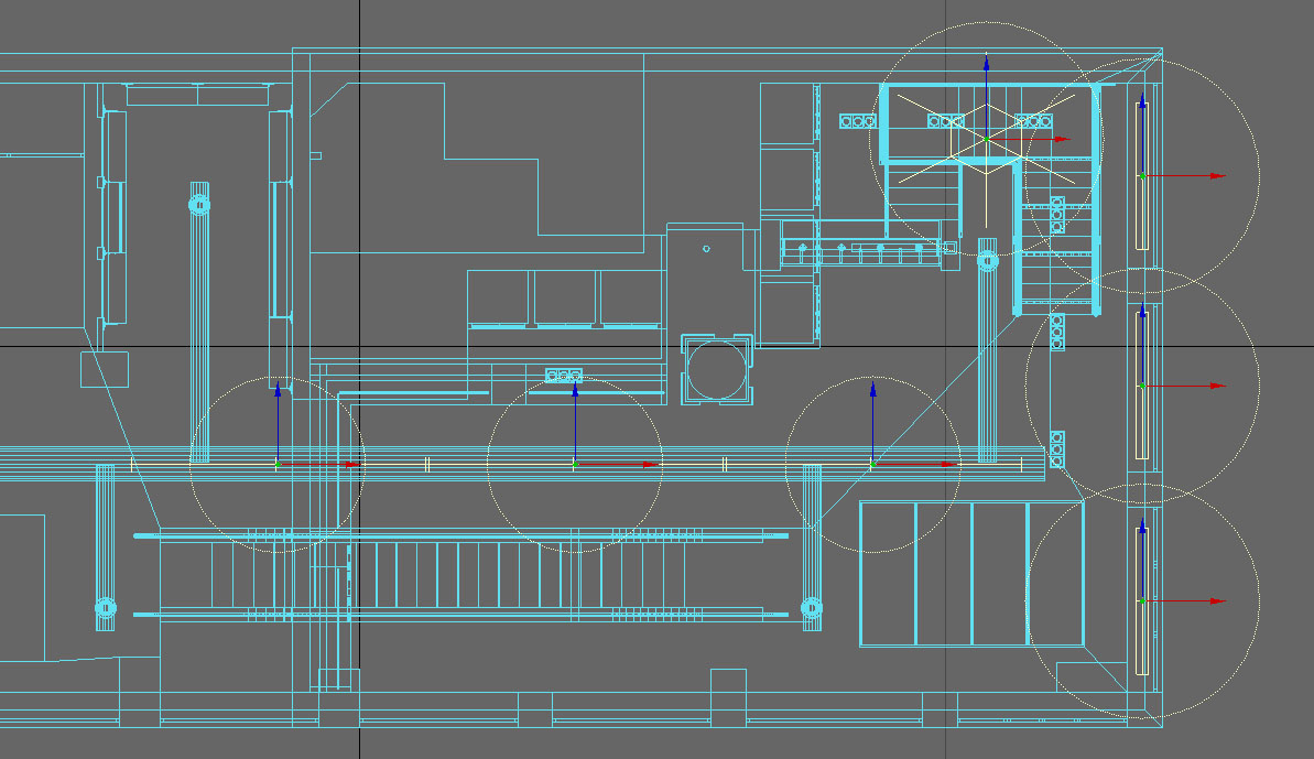

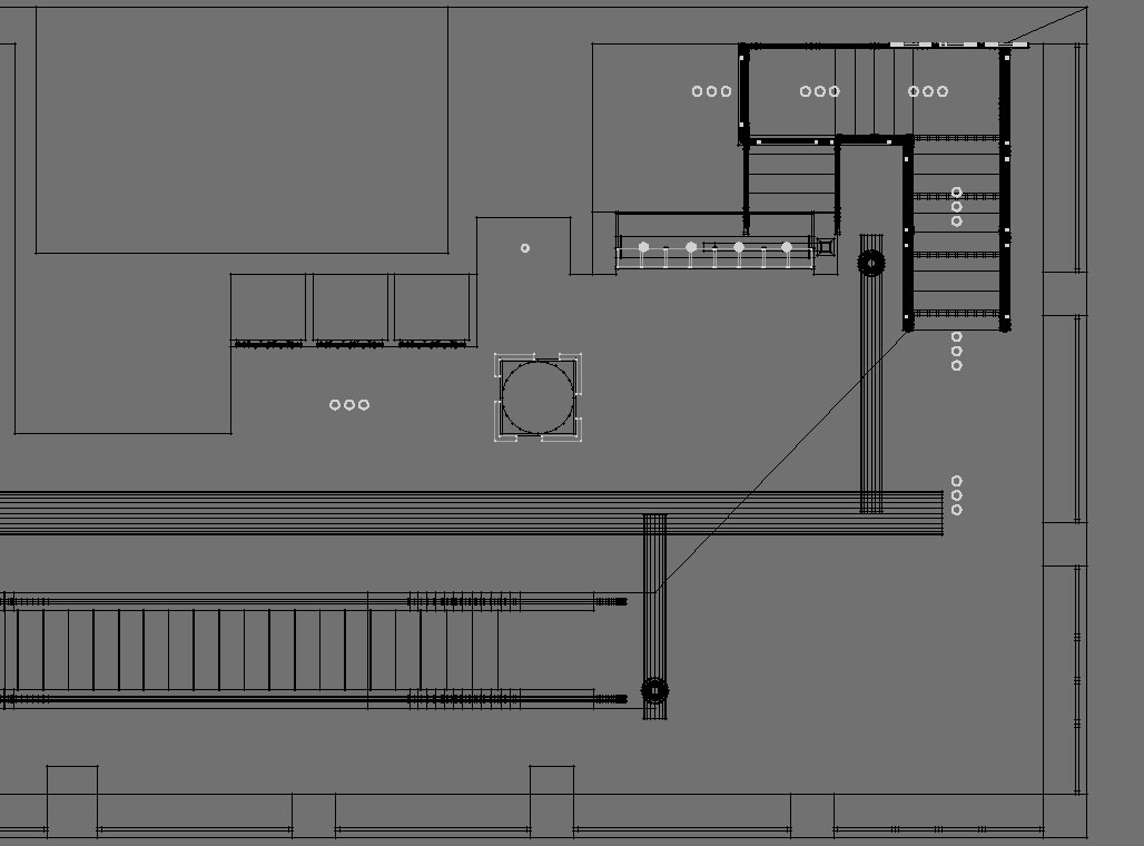

In the image lw_ligt and poly_light there are my light setup.

I'd use less reflection on the wall and turn down max rays for refl/refr blurring accuracy limit (100-200). There also might be issue with bump causing those specks.
I also wouldn't use lumi polys to light this scene. Spot lights should work just fine. Try to simplify your lighting.
Also.. what are those linear lights?

Linear light is for simulate neon above tube of air-conditioner.

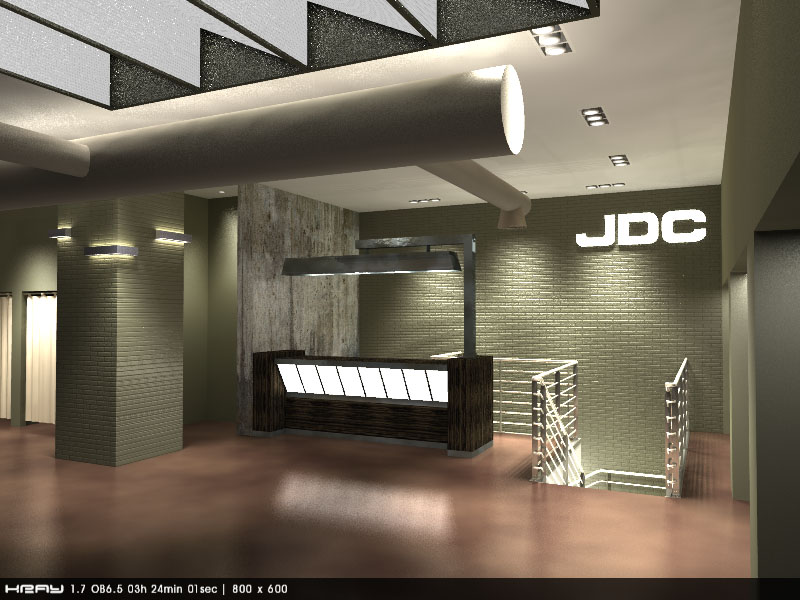

I've used lw spot light and this render is better of my previous ...
